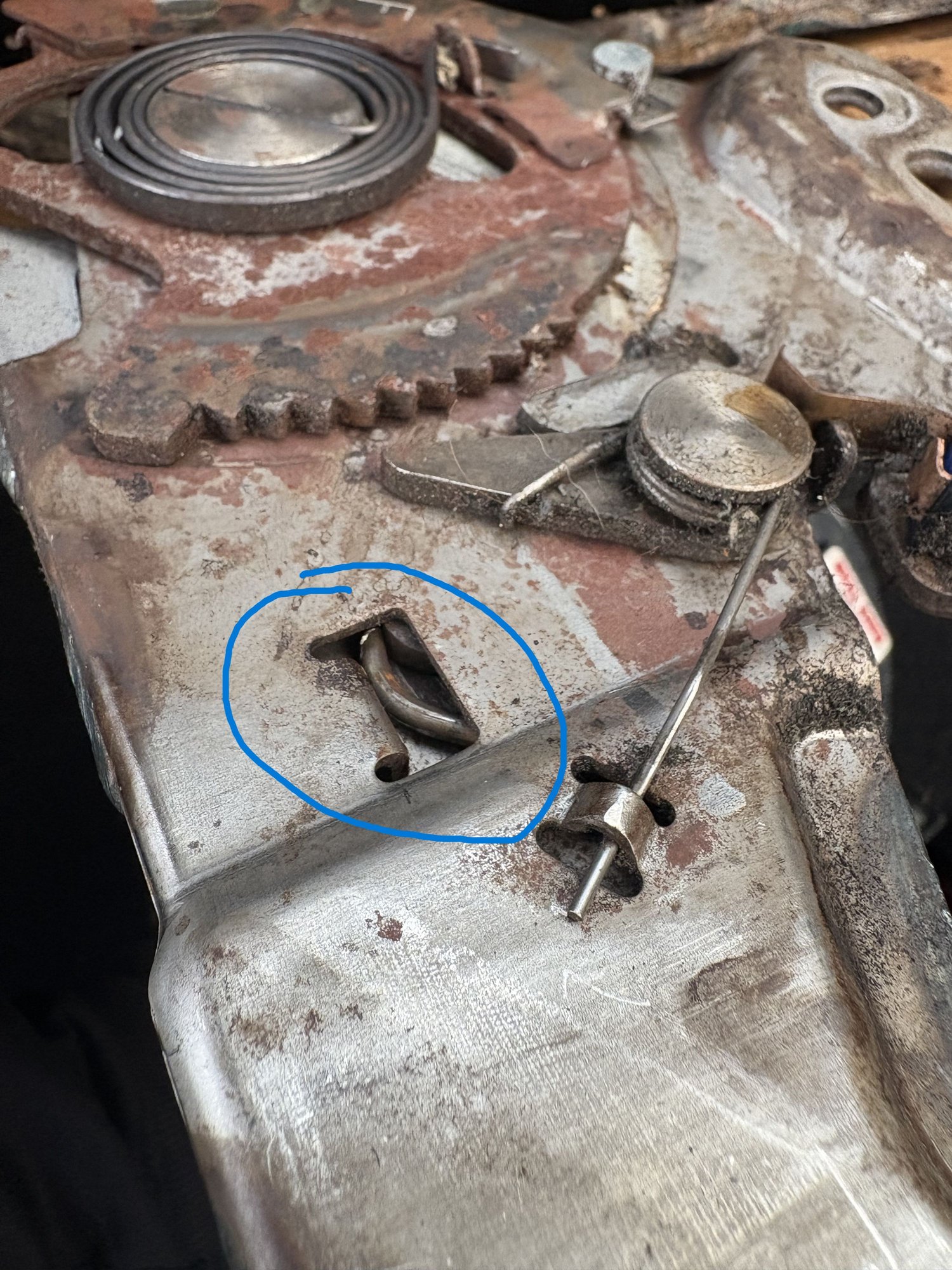

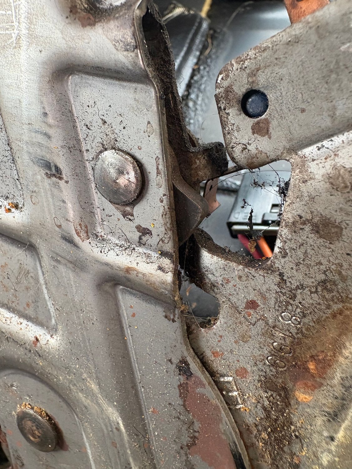

Hello, I have let my C5 sit for about two months and before it did sit, the parking brake worked perfectly fine. Two months later now, I go to pull it and it seems as if it is not ratcheting to lock in place at all now. Would I need to buy a whole parking brake assembly or would there be a way to fix the one I have?

Depends on the issue. You need to inspect the system (cables, the brake lever etc.) to see why it is not ratcheting. Without an inspection, hard to say what's up.

I believe it is this spring that controls the little block to perform it ratcheting as it looks like a piece of it broke off and is too short now to engage it.
