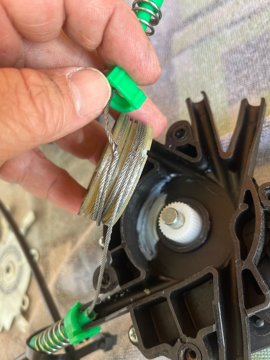

Well I replaced the window. Used a video on YouTube for a reference and guide to set it. Here is a pictures of the spool in the motor.
Old Jan 10, 2026 | 07:21 PM
60 SHARK's Avatar
60 SHARK
Joined: Aug 2016
Posts: 2,343
Likes: 1,173
From: CLEVELAND STUCK IN OHIO
New one looks better doesn't it. ..
Now throw that one in the ♻️ recycling bin,,
Good job....
