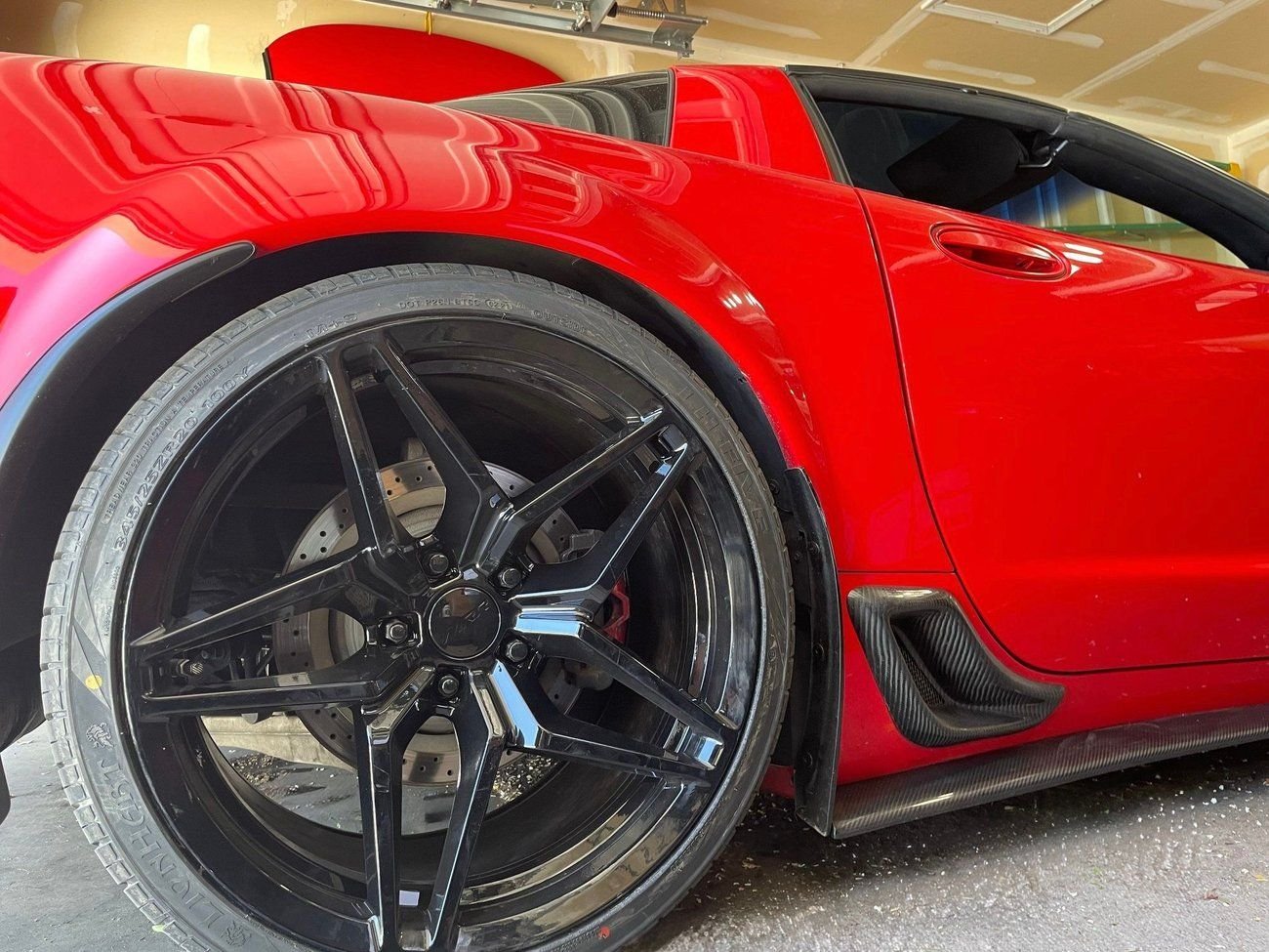

^ A zero offset would look like this or probably worse
Old Jan 3, 2026 | 11:15 AM
SattarC5's Avatar
SattarC5
Joined: Jul 2025
Posts: 115
From: San Marcos CA
gotcha thank you for that example, from the looks of it, a 2 inch front and rear flare would clean that gap right up
