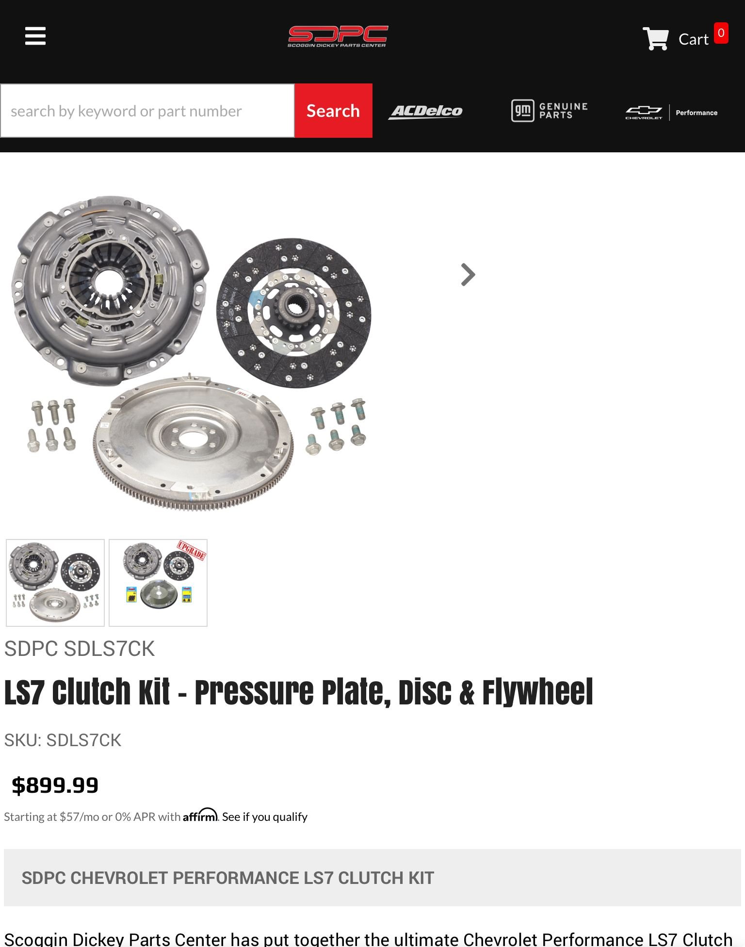

Unfortunately I don’t know the individual part numbers. I bought them as part of a kit from Scoggin Dickey about five years ago. Same as linked below, although about $350 more since I got mine!
I bought the standard version with the steel Corvette LS7 flywheel, but if you use the link to their site it states they can upgrade this kit to a lighter flywheel.
Perhaps you can call them for the specific info. They have good customer support
https://sdparts.com/i-23179965-sdpc-...-flywheel.html
