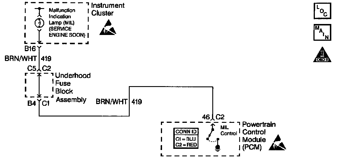

Hello, I just had a quick question regarding a P0650 code on my 2000 Corvette. I was wondering if its repairable at all at home or if I would need to send the cluster to someone who specializes in taking them apart and fixing it for me.

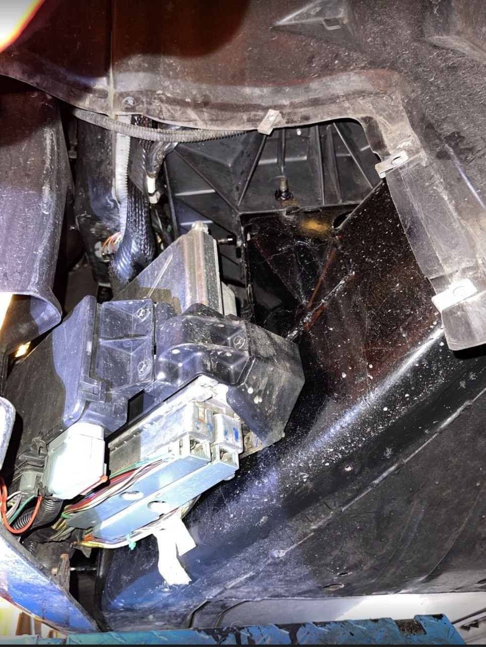

Hello, I know it's been a while but I finally got to following this guide, I am so far on step 3 and am confused where the PCM connector c2 is. Could I get some help locating that?

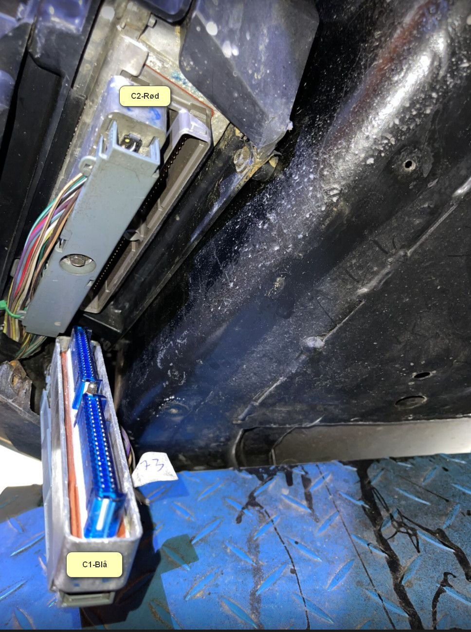

Below battery is the PCM with two connectors.
Blue is C2 and Red is C1
