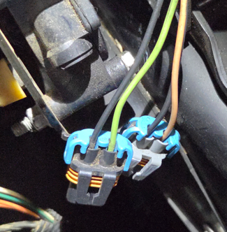

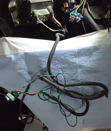

Update. 26.01.16.
My LED light bulbs have arrived. They are directly connected to the lamp line and confirmed that it worked.
And I cut off the messy HID harness that was left.
But there are two more problems.
1. If I turn off the light, the eyes don't go down. When I turn on the high beam(only push case), those eyes going down.
2. It also blinks when all lights are turned off.
I temporarily disconnected the battery power. I think I should probably buy decoders.

Yes, sorry forgot to mention that the headlights won't go down as normal with the led bulbs. They make a specific resistor kit (which is what I use) and you only need 1 total not per side. Not sure if the seller can ship to Korea but I would think he could do that as he has customers all over the world. Let me know if you'd like the link information.
Not sure about problem 2.

Thank you for your valuable experiences and helpful answers.
I'm still testing the current phase.
My car's LED headlights are causing a current malfunction.
Issues 1 (headlights not going down) and 2 (flickering) have been resolved without any additional maintenance, but intermittently, only the left headlight don't go down and the headlight gear spinned.
*The headlight gear issue is a separate issue and should probably be replaced with a brass gear.
Since I don't drive my car very often, it will take some time for further road tests. I promise that once I've finalized this issue, I'll write a comprehensive guide on converting from HID to LED. (It would be a simple exchange...)

I'm going to wrap up this post. The LED lamps I installed are still working fine.
1. Philips ultonon rally 3551 50w HB4 socket.
2. I removed all the previous hid wires.
3. The hid base was reused.
Good luck everybody 🍀
