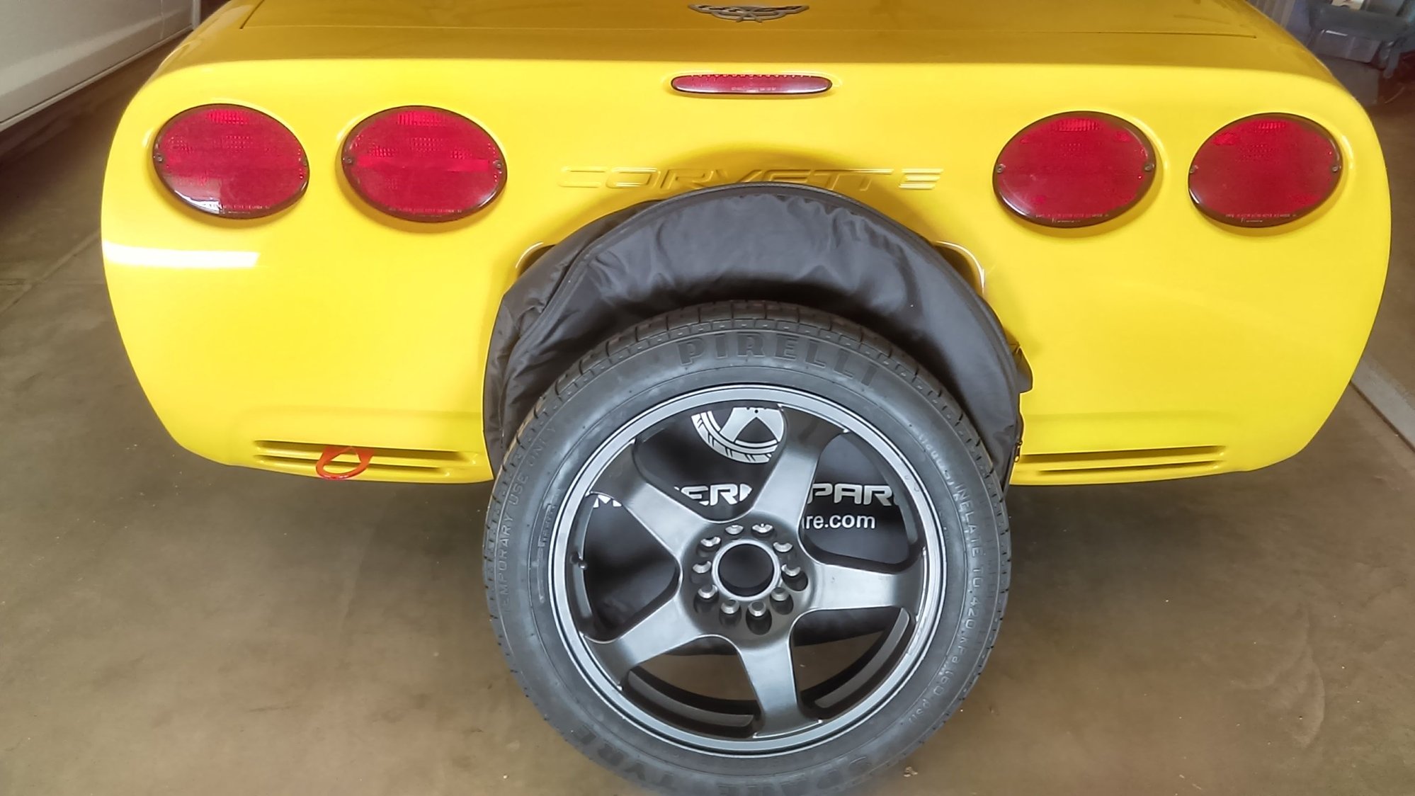

2001 Base --- looking for a donut spare tire that would fit both front and rear --- any suggestions? Many Thanks

Late model Pontiac GTO donut spares will work.

Pretty good discussion of options in this thread: https://www.corvetteforum.com/forums...e-project.html
Some good information at https://sparetire.com/Chevrolet/Corvette/

@Dads2kconvertible posted the link to my spare tire project above, using the Chevy Equinox spare, cheaper than the GTO spare but takes a little more work to make it fit, but both have to be modified in a similar fashion to make them work.

Modernspare.com:
