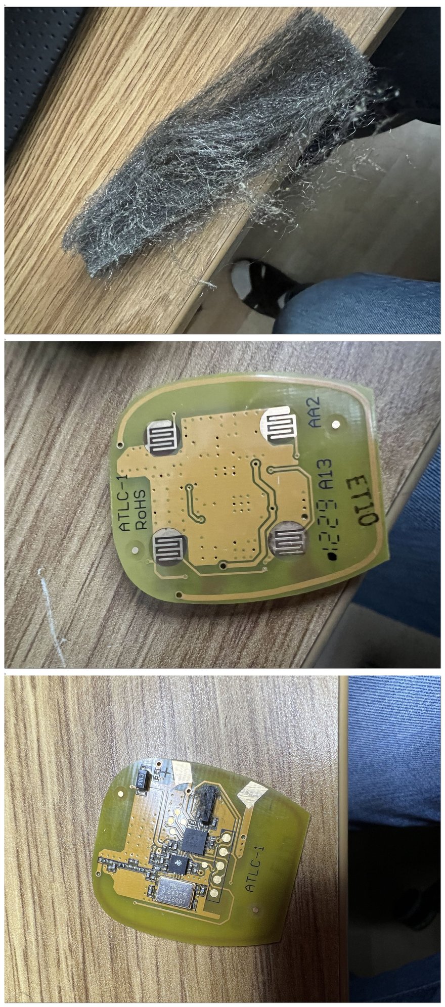

I took one if my FOB's apart and used some steelwool and cleaned the contactsurfaces with it and it start working again
