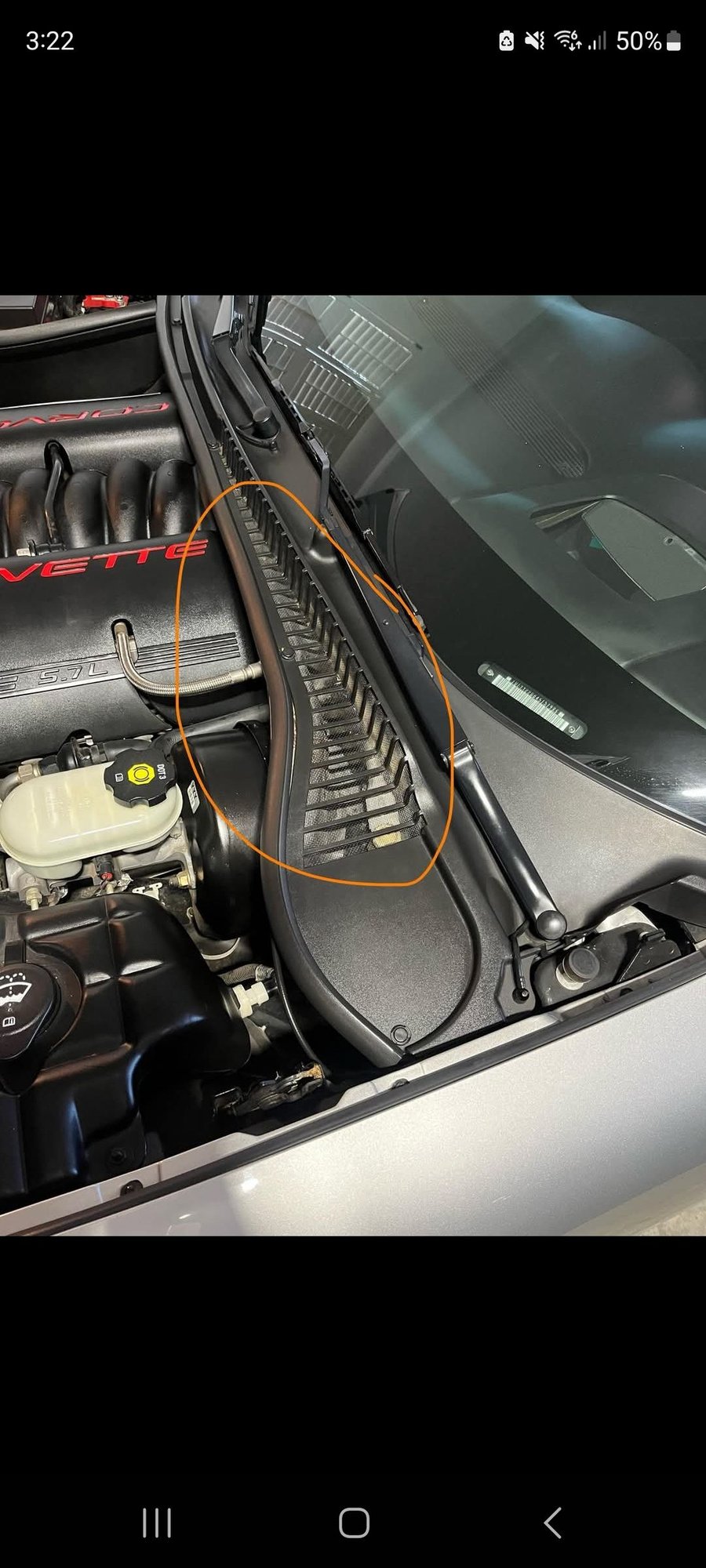

Spray it into the cowl this way it goes through the evaporator and all the ducts
Set the climate control to fresh air on high
