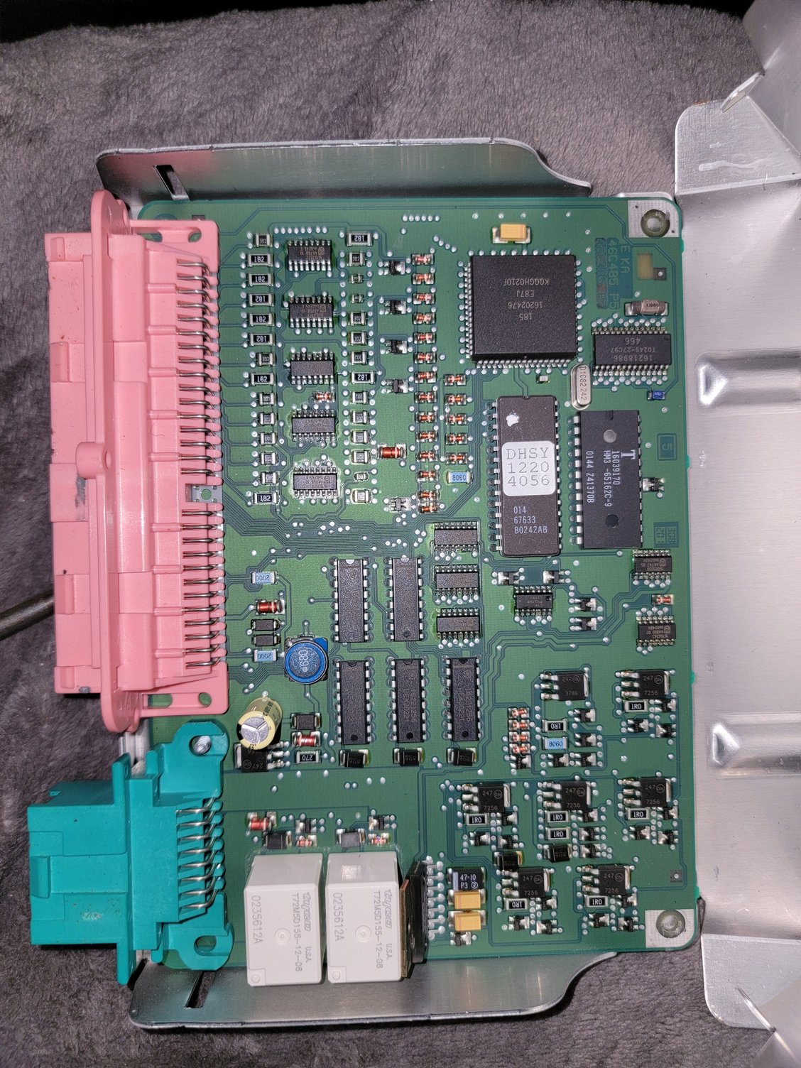

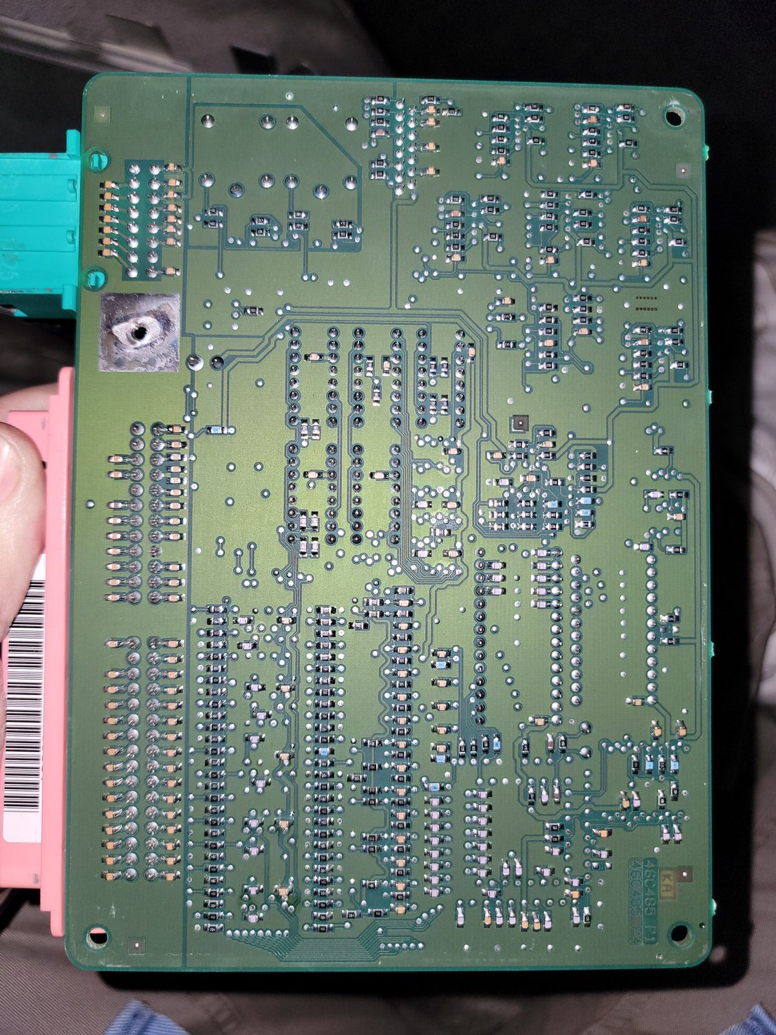

So I decided to pull the bcm apart to see if there was any corrosion or solder points all look to be fine.

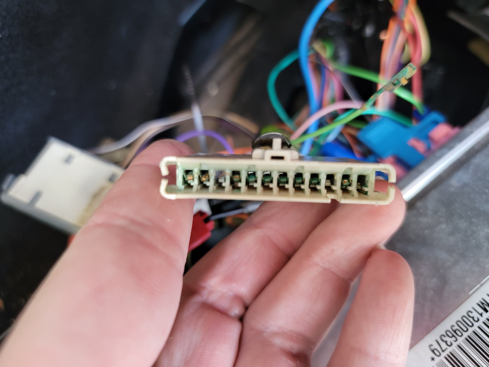

Sounds very much like a problem with the can buss, all of the modules on a c5 corvette communicate with each other on a single wire. If one of those modules has a problem with either the 12v power or ground it will cause all modules to stop communicating with each other, especially the BCM to PCM. Try shaking the rubber accordion tube between both car doors and the car, this is an area where some connectors develop loose electrical contacts. There is a procedure where you remove some metal jumpers on two connectors next to the BCM, this is where all the modules are connected together. Maybe c5 diag will post the procedure.

I believe i may have found one of the culprits for my issues lol ! I found the star connectors have a lot of corrosion on most of the wires.

You might want to disconnect the negative battery cable and disconnect the BCM and pull its cover off to check for corrosion, your car has most likely had some water intrusion. Good luck.
I already did that and posted photos of it in the thread. The board looked fine to me. Including all the solder points.
