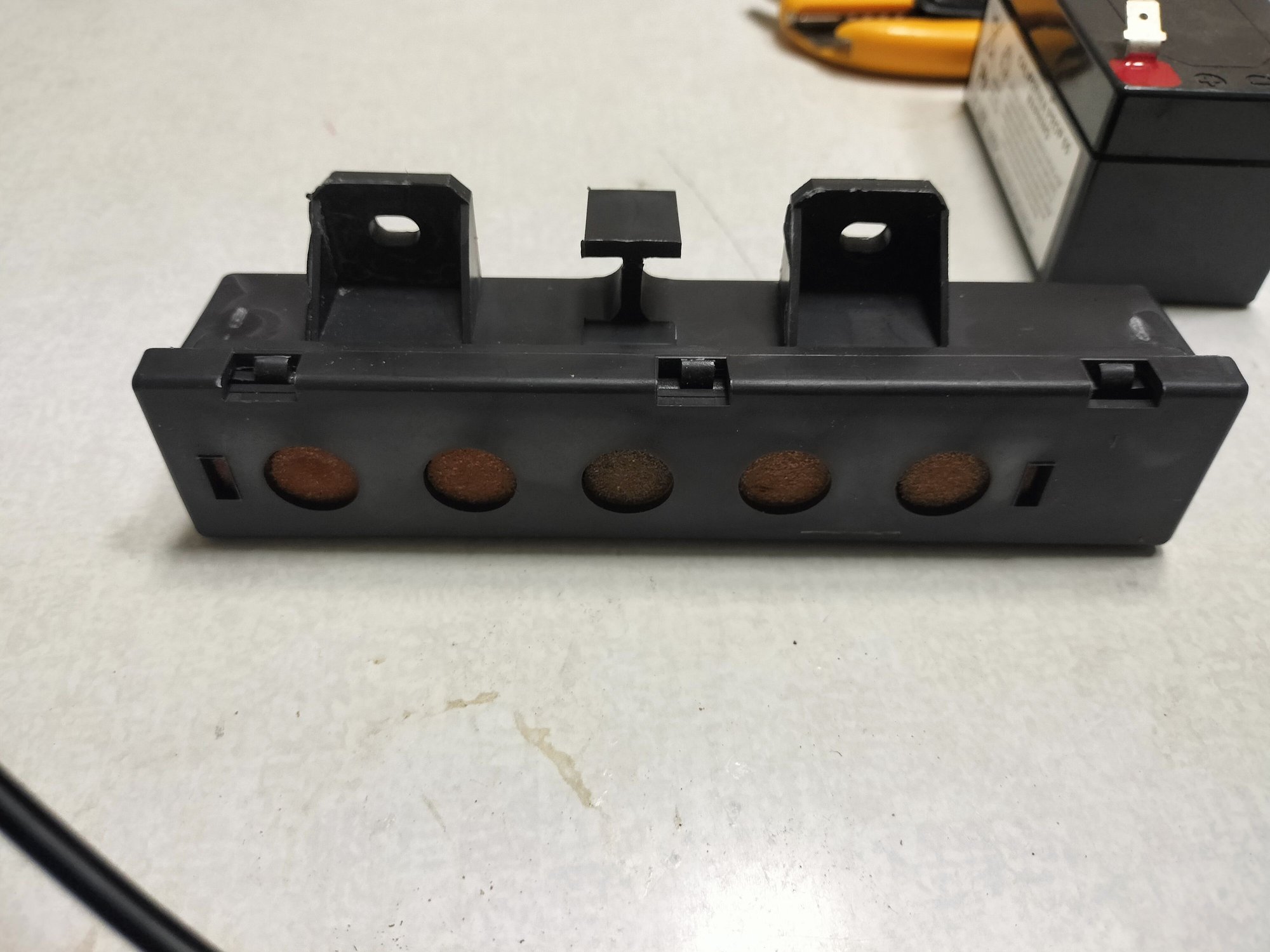

I’ve heard that replacing the blend motor is difficult. Should I check the vacuum system first?

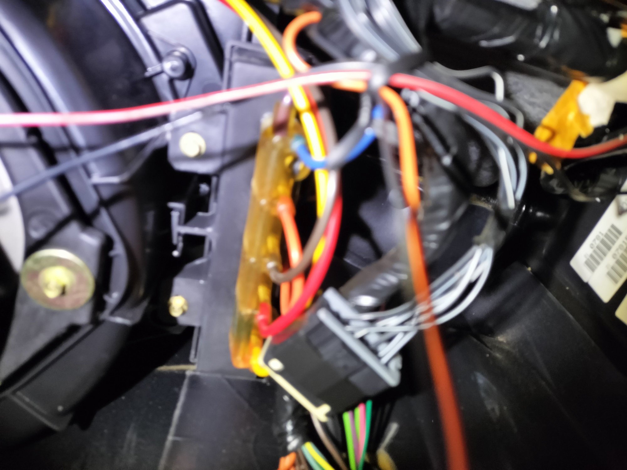

[QUOTE=yongdaodali;1609436906]
Yes , the hose run to the back of the manifold. The hose is small maybe 1/8 inch. So i would start in the back of the manifold and work your way to the cabin. I think its in the wire harness if i remember correctly. Yes its there on the back. Its very hard to see, you might have to get a mirror to verify that its connected.
I had a similar issue, what i did was find the hose in a workable area cut the hose and find another score of vacuum and check if the door moves. If not you have to keep following the hose tell you find the crack or it separated somewhere. Google the route of the hose. Or if you can reach the hose on back of the manifold without taking off the manifold, so if you don't want to cut the hose.

I removed this part today and tested it, and everything seemed to turn on and off without any problems. I also looked around and saw that the black hose seemed to be extending into the engine compartment. The others were going to the blower motor side. I couldn't trace it from there.
