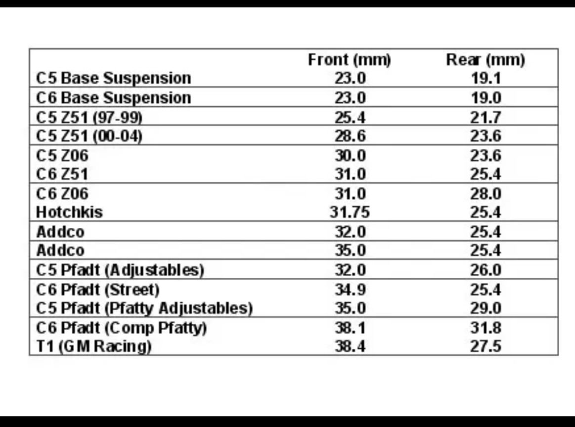

There are replacement shocks on Amazon, in case you want to stay with those. I went with Bilstein B6 shocks and C6 Z51 sway bars, but paid my tuner $300 to tune out the F55.
The B6’s rode kind of rough, but for whatever reason, the thicker sway bars completely fixed the ride issues.

Also, if you prefer a softer ride you can use the GM OEM base “soft ride” shocks that match up with your sway bars. If you have a caliper to measure, the base sway bars are 23mm front, and the rear bar is 19.1mm. Just depends on the type of ride you want; stock or more performance.
