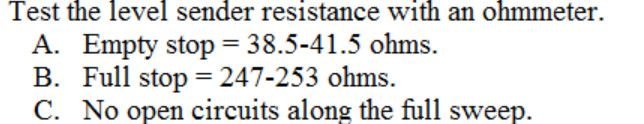

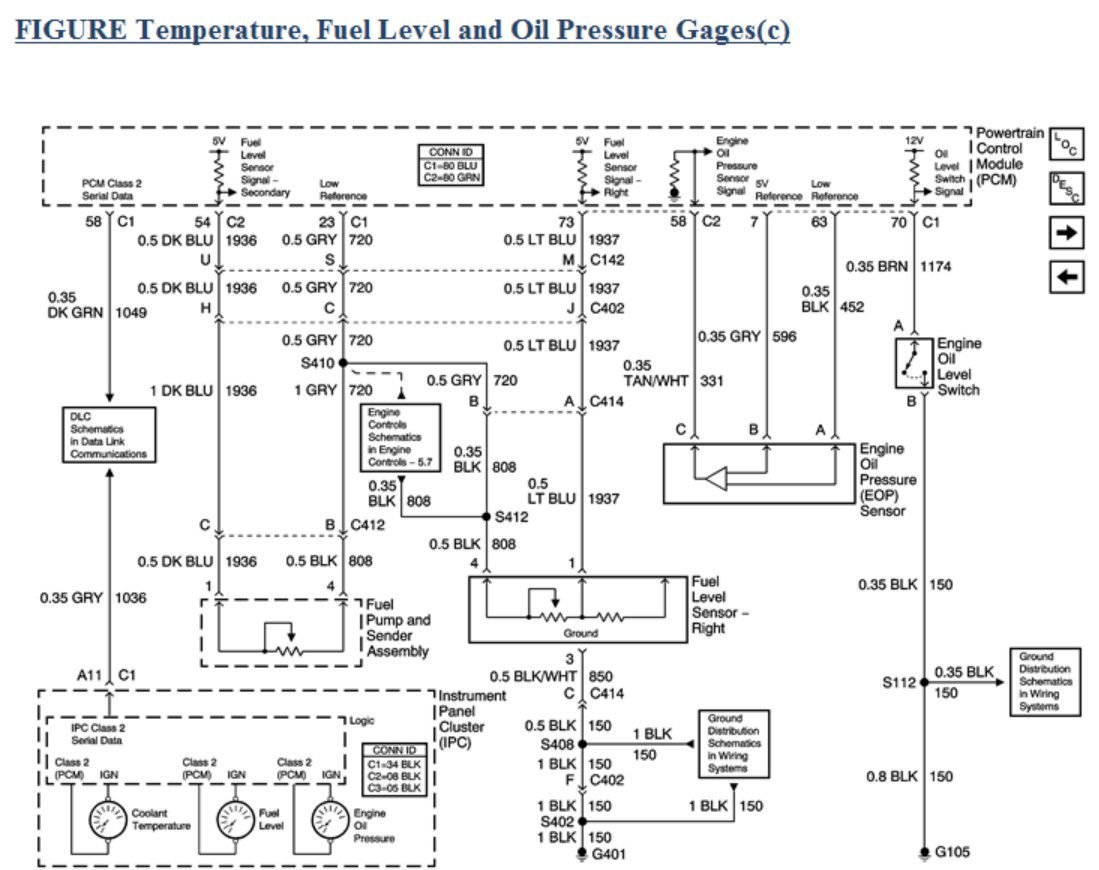

You should get some diagnotics on your sensorsignals from both fueltanks with a Tech2 or similar
When both tanks are 100% full the sensors values should be approx 250 ohm and give approx 2.5 volt each.
With fuel consumption the right sensor votage will decrease until right tank is empty and then the left sensor signal decrease when fuel level decrease in left tank.
If this order of fuel sensor sensor signal does not happen DTC's wil be set.
But with viewing the sensorsignals it should be possible to observe which sensor causing problems

C5s are known to have fuel sender issues. Especially if the car has been using cheapo fuel with high sulfur content. My car started having issues similar to yours at around 110,000 miles. I removed the senders, and they were pretty well worn out. I changed the senders. New ones from Rock. Be advised that, AFAIK, new ones are no longer available. Plenty of info out there if you search. Sometimes Techron wil help clean dirty senders. But you'll find that, eventually, you'll spend more on Techron than new senders would've cost. Good luck.....
