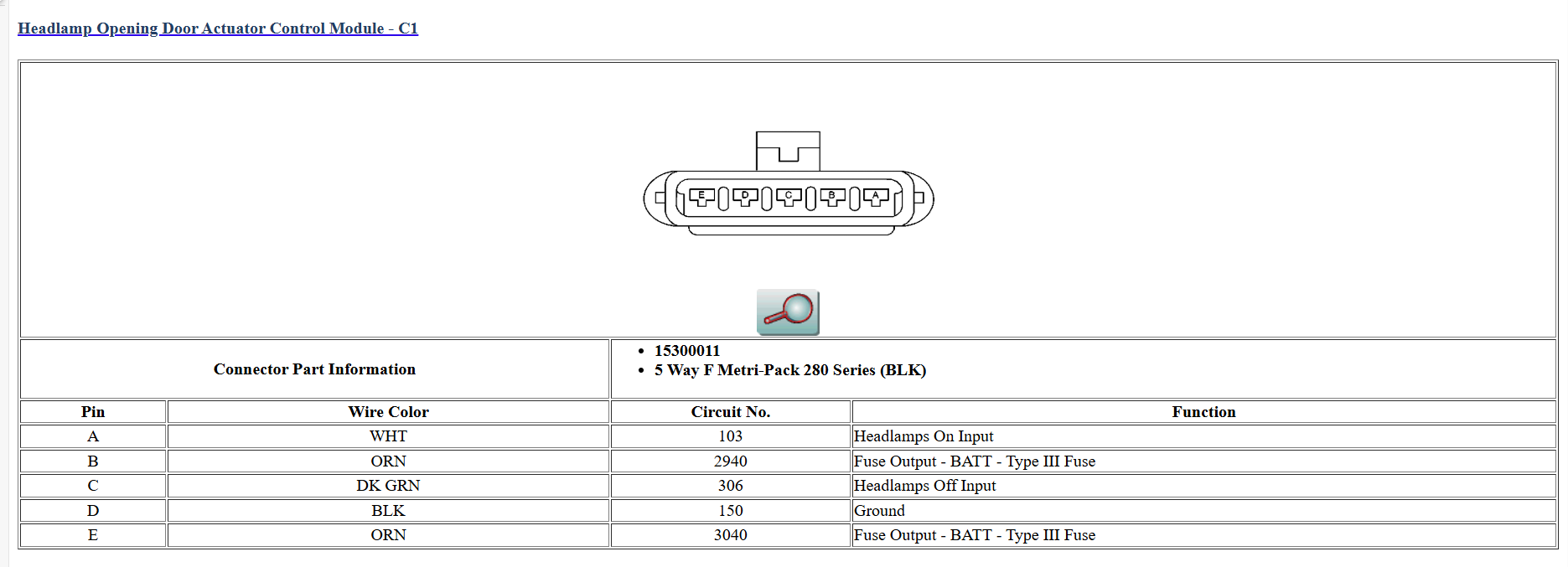

How did you determine it is the module? Did you already evaluate the 12v inputs and ground at C1 of the headlamp door control module?
