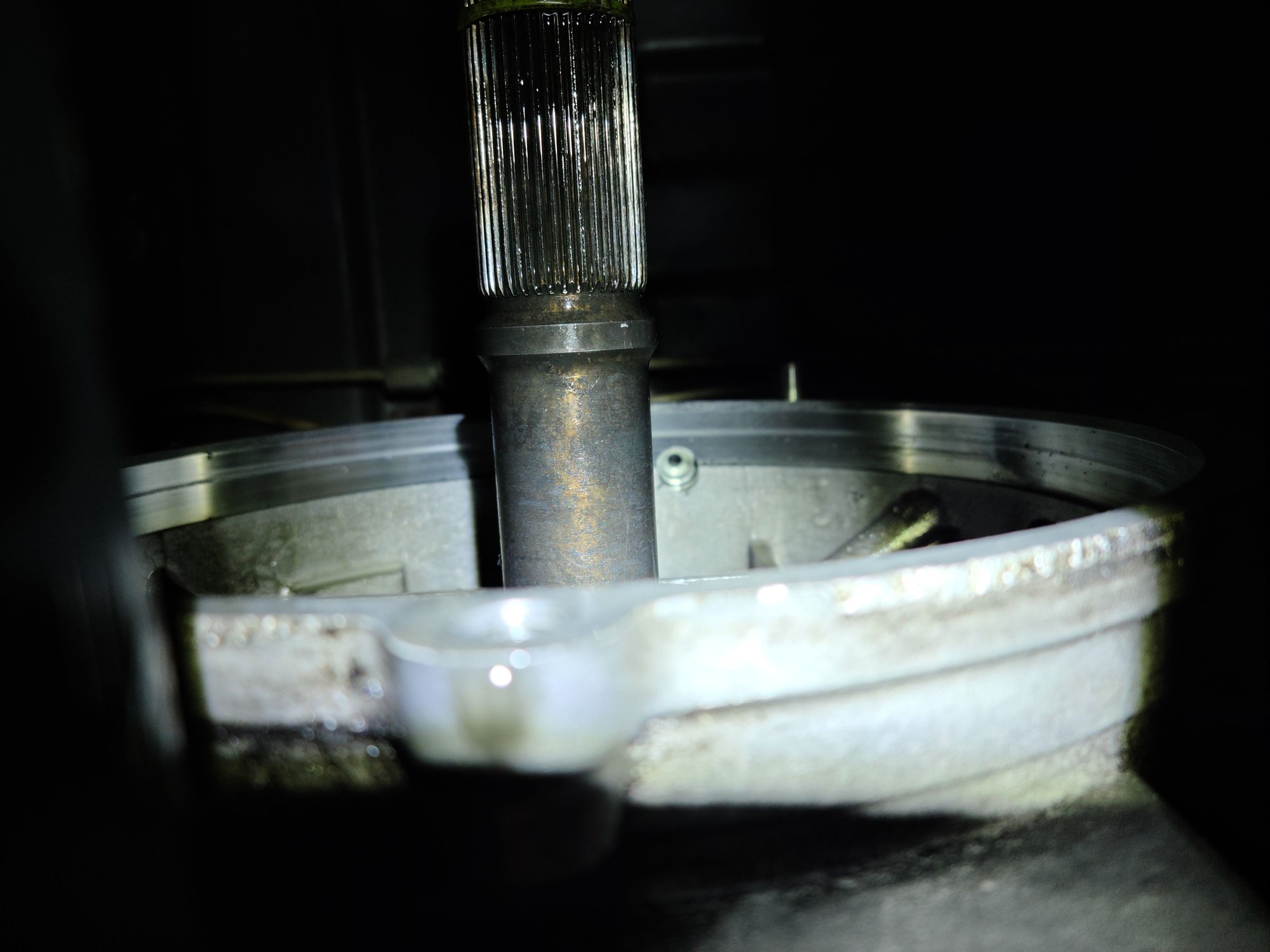

At this point, I already had my diff side covers off. Even tho I'm working on a 4 post lift, I still couldn't get my head up there to see it. I did get a bit of a look at it with a mirror and I got a pic with my camera, but those confirmed that there wasn't enough length to securely clamp a hose to. With the driver's side diff cover off, I could look up into the diff and see the bottom of the vent. That's it just to the right of the axle in the pic.

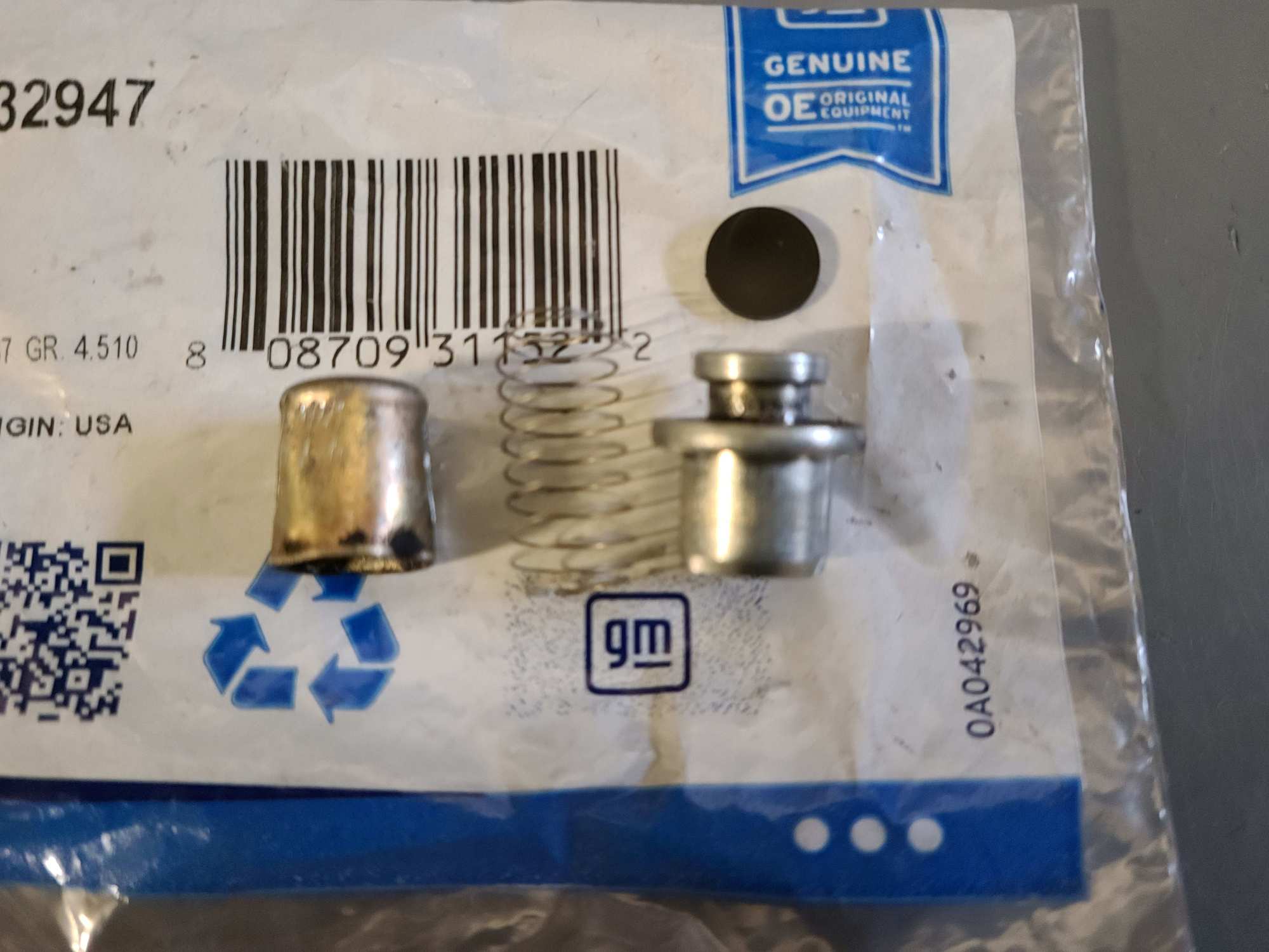

I had a piece of 3/8" dia steel bar in my roll away, and was able to easily tap on and move the vent from the bottom. I was just trying to move it out a bit for a better length of material to attach the hose to, but it popped out of the diff after a couple of light taps. Here's a pic of the pieces of that vent.
As you can see the body of the vent's top shoulder that a hose would attach to is very short. It measures about .218" or 7/32" in length, and it's about .437 dia. We got our C5 in 2006 with 32K miles on it, and I'm pretty sure that's the vent it left Bowling Green with. I would not feel comfortable clamping a piece of 3/8" hose to that short length of 7/16" "tube".
