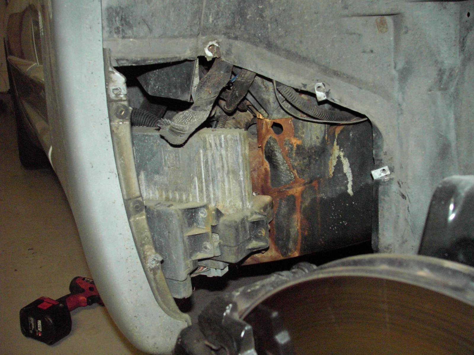

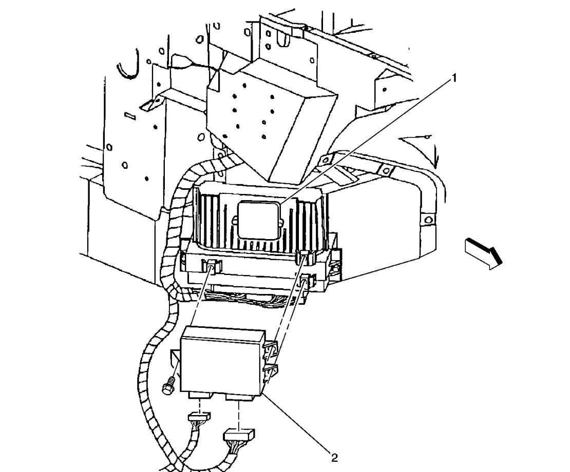

Thank you for the feedback, especially on the PCM verbiage. So on my 1997 Corvette the PCM is located behind the right front wheel. When the harness comes in from behind it does the blue connector go on the inside or outside of the PCM. I know they are keyed but that PCM can also be put in 180° off and the wiring harness could also come in from in front of the PCM versus the rear. That's why I want to clarify when coming in from the rear is the blue connector on the inside or outside of the PCM. Thank you

It is written on the PCM receptacle which color goes where. I just looked at one thats for sale on Ebay and it shows the outside connector is red.

thanks a bunch. Very helpful. Yeah my markings where it was noted red or blue have been worn off but you confirming red is on the outside is huge. Thank you again
