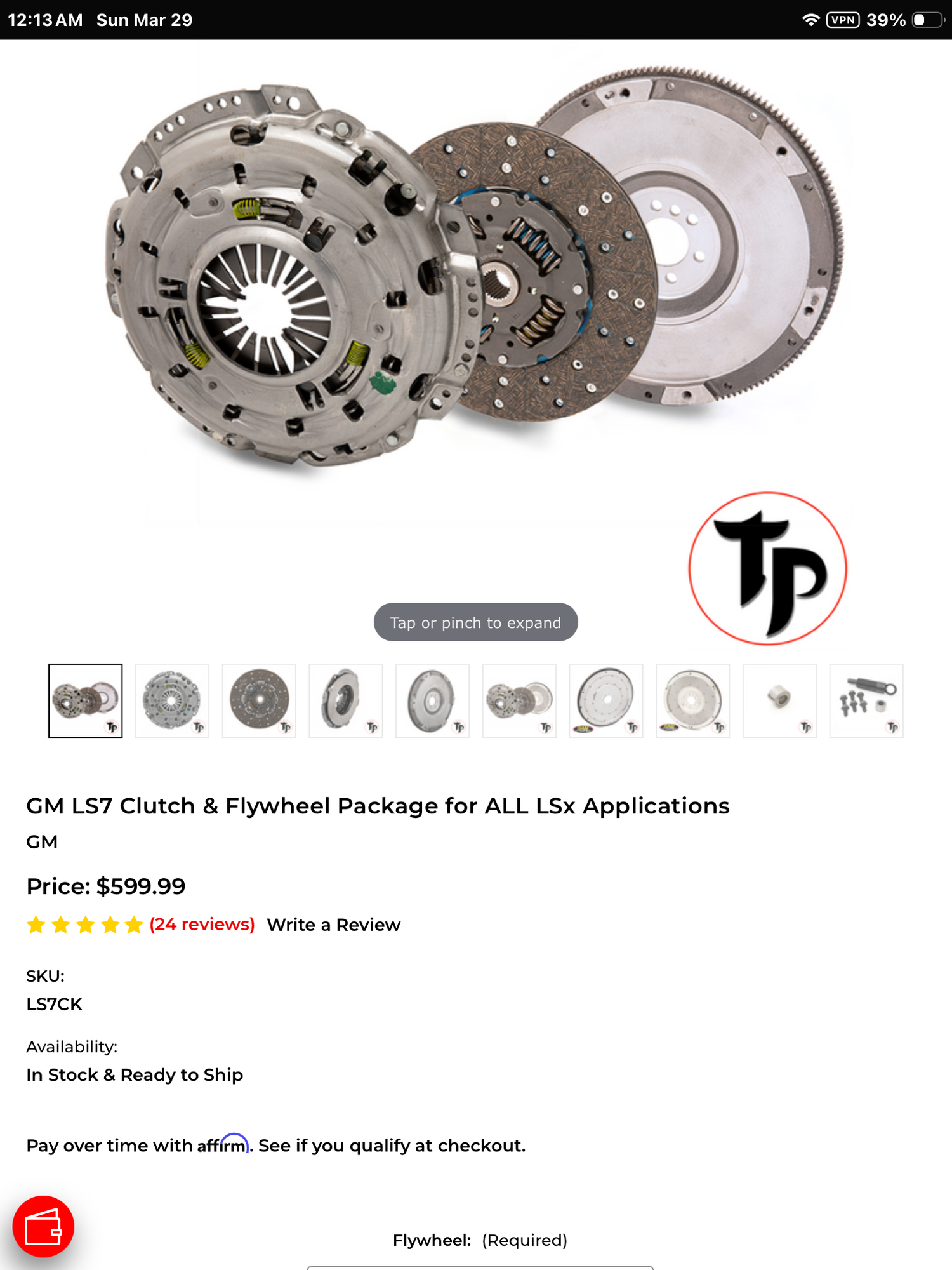

I have the LS7 clutch and about the same mods on your to-do list and it’s fine. You can go with a McCloud, etc., but I believe even they will tell you it’s overkill for the power you’re considering.
There is a variant of the GM kit with a lighter flywheel if that fits your needs. The optional RAM 19 lb flywheel vs the standard 29lb flywheel from Scoggin-Dickey, Tick, etc….
Ticks price for the kit looks realllly good at $599. I did a double take when I just looked that up.

Lowend: I could have missed something…but the Tick ad seems to be less expensive than stated in the comment above.
Tick is selling the LS7 kit for $600 + $200 (RAM Flywheel) = $800, close to $500 less than an aftermarket clutch.

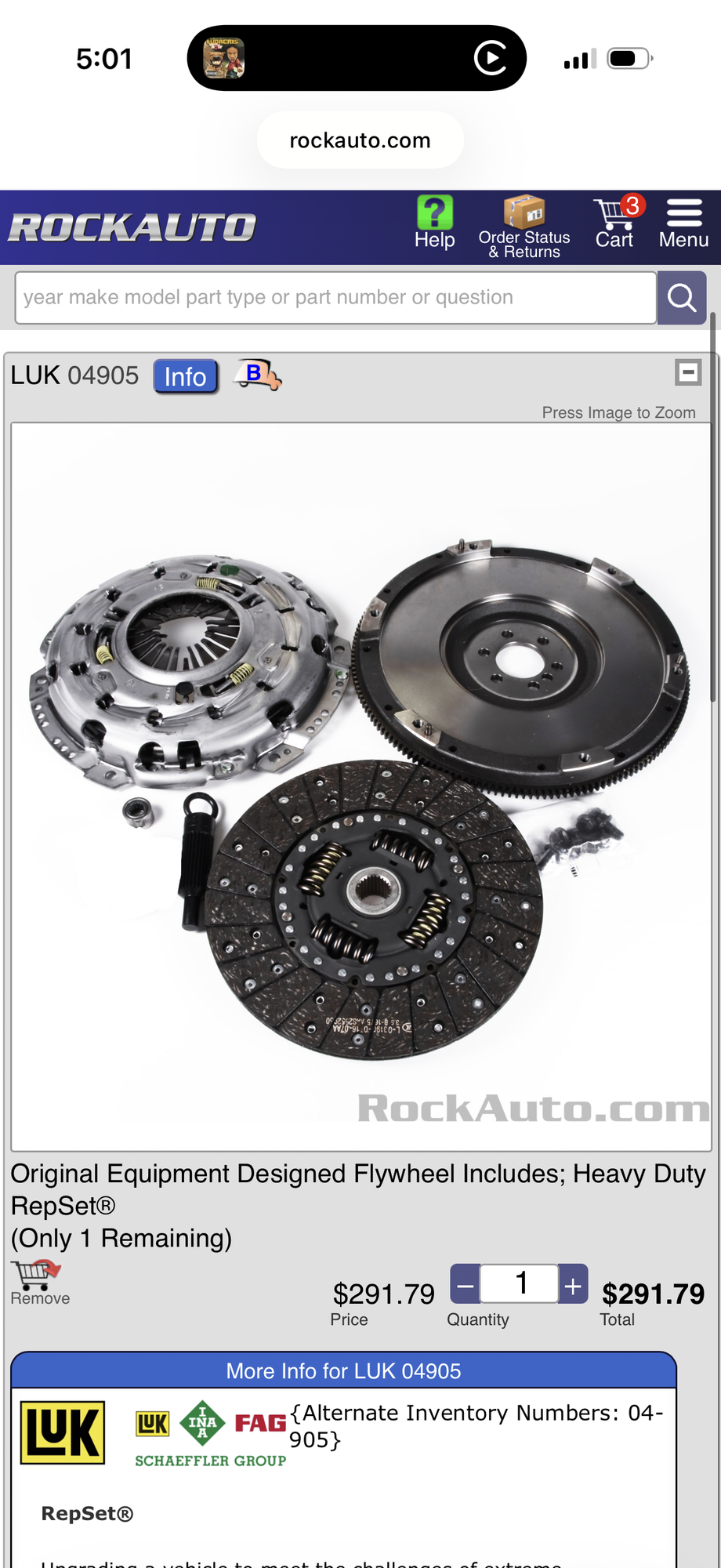

I think the 1100 one includes all the hydraulics but wondering if it’ll be cheaper to get the ls7 clutch from tick and then the slave and master from rock auto.

Am I missing something here or is the luck 04950 the same as the ls7 clutch and about 200 bucks cheaper than the prior version linked? Other than this, would I just need a new slave
Haven’t heard any complaints. LUK does make parts for GM, but I have not seen evidence their branded kit is the exact same material and quality control as the GM kit. Maybe…. For example some brands of LS7 lifters are said to be made at the same production facilities as GM parts, but the GM OEM parts are inspected every dozen parts, whereas another brand might be everyday. I don’t recall the exact ratio, but it is something crazy like that.
When taking the entirety of a full clutch job, labor, parts, headache, going all GM is peace of mind for me. The GM clutch assembly is the same as designed for the C6 Z06, so it’s stout. Tick master cylinders are a higher performance alternative but not for everyone, so you could search some forum posts for user experiences.
Definitely get a new slave…
You can use your old master cylinder, but keep in mind if it’s the original it’s 20+ years old and going to have a shorter life span. They are not that expensive so it’s prudent to have a completely fresh hydraulic system.
Looking forward to learning what you end up with and up your thoughts on the outcome. Good luck 👍
