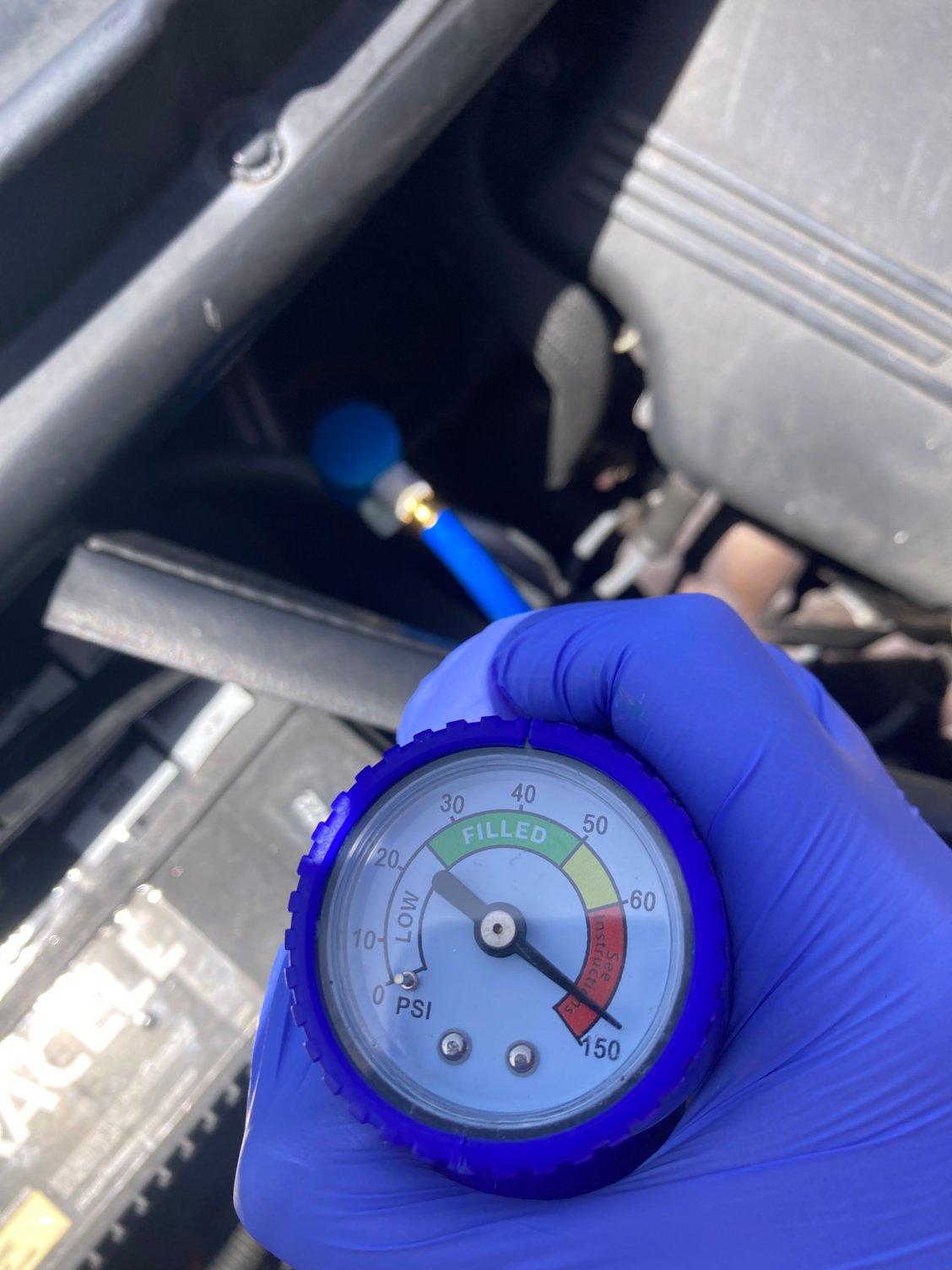

my low pressure connection is over pressure

How did you determine the low pressure side is high? Gage set or gage on a can?

the ac light stays on when I press it and I used a gauge with a can and the low pressure was in the red.

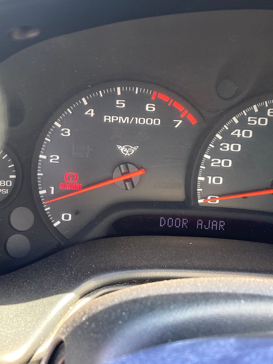

when I turn on the ac button my car goes from 600rpm to 700rpm and when I turn the button off it goes back down to 700 rpm

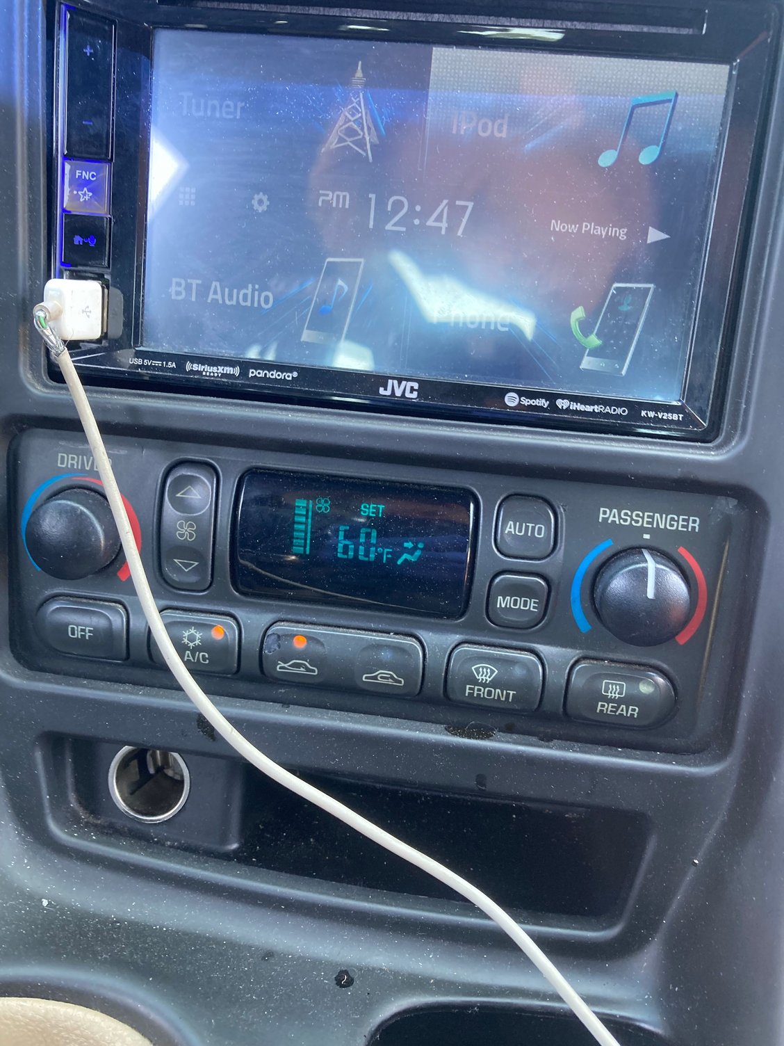

This is a picture of my ac settings and the pressure gauge (also when I hold the trigger on my gauge it’s mostly just steam and only a little green refrigerant that comes out)

I tried to bleed out the air and put in refrigerant with stop leak but the temperature is still not changing. The pressure is stabilized in the green zone now though at least.

honestly I was throwing spaghetti at the wall, I figured the system is over pressure because it’s nothing but air in it so I held the trigger down on the gauge with no can attached to bleed the air pressure and then I’d add refrigerant when it hit low and rinse and repeat and I went through a decent amount of refrigerant without losing any no obvious leaks and the pressure is no longer in the red but in the green and not moving.
