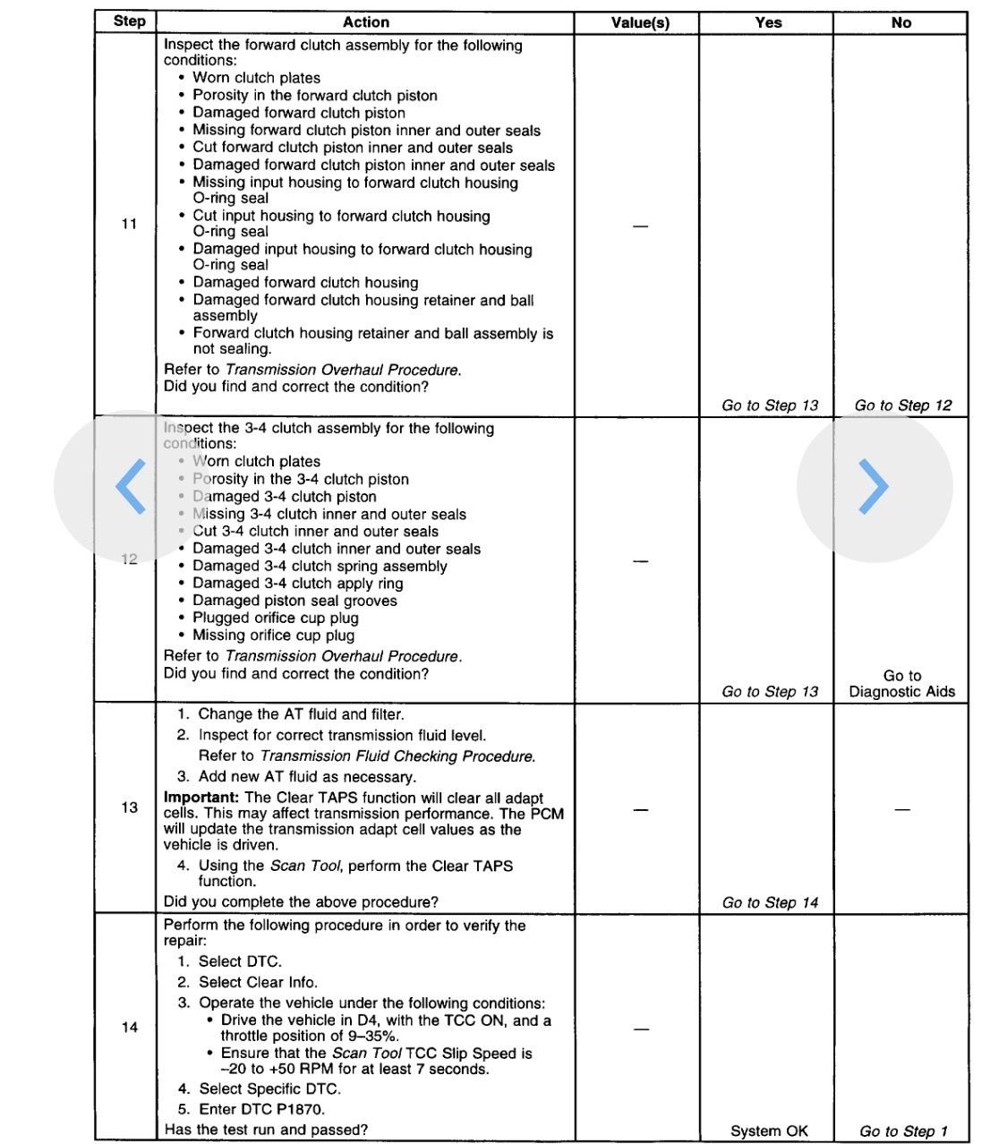

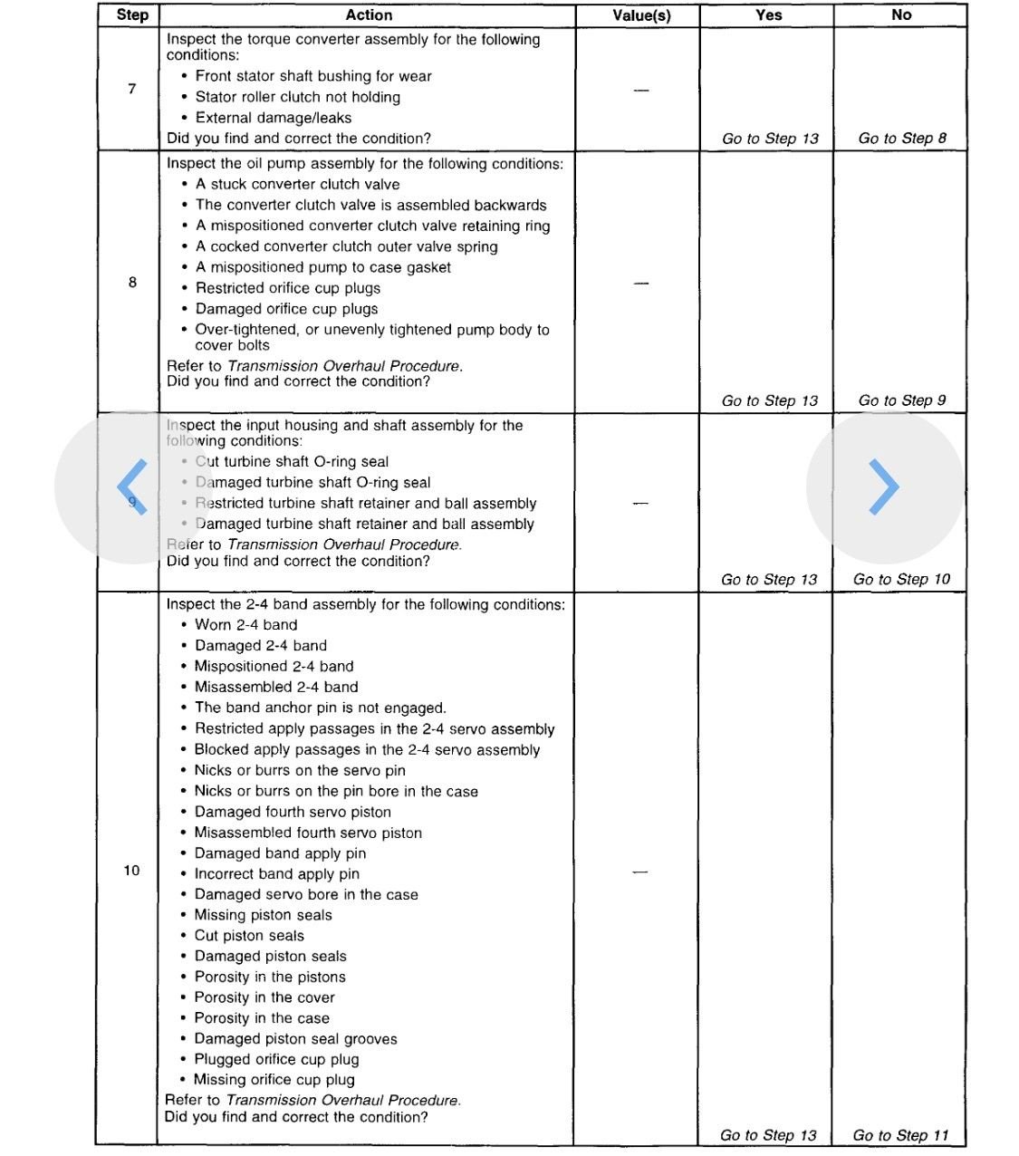

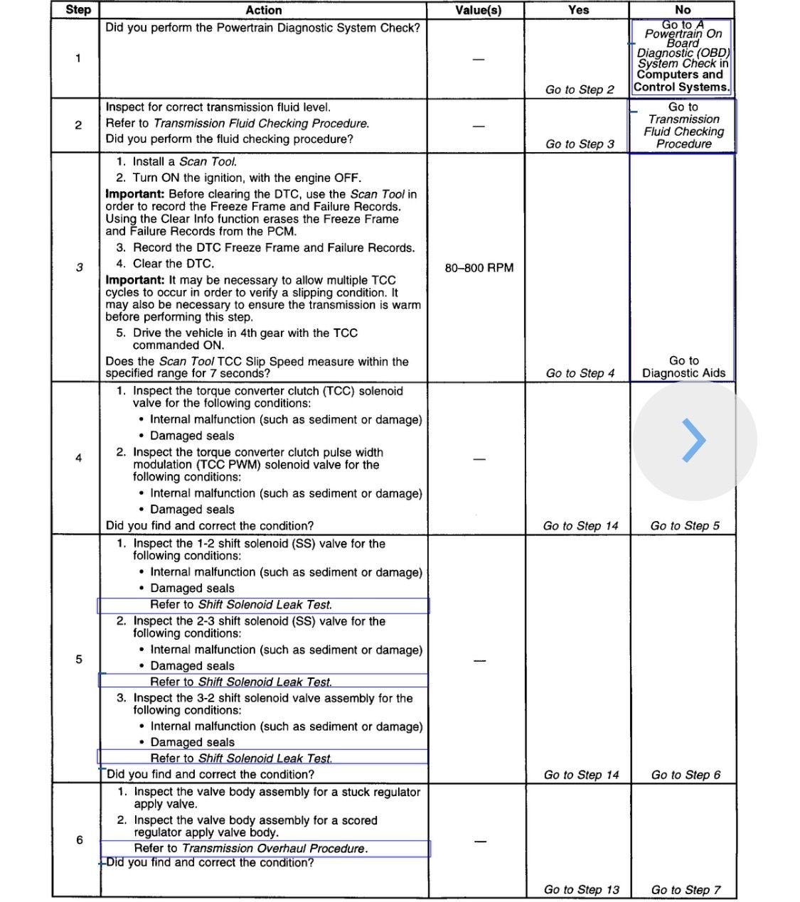

First is good to know what model year...if the DTC comes back I'd take it back to that dealership...if you want to diagnose this DTC you can follow the flow chart below.
