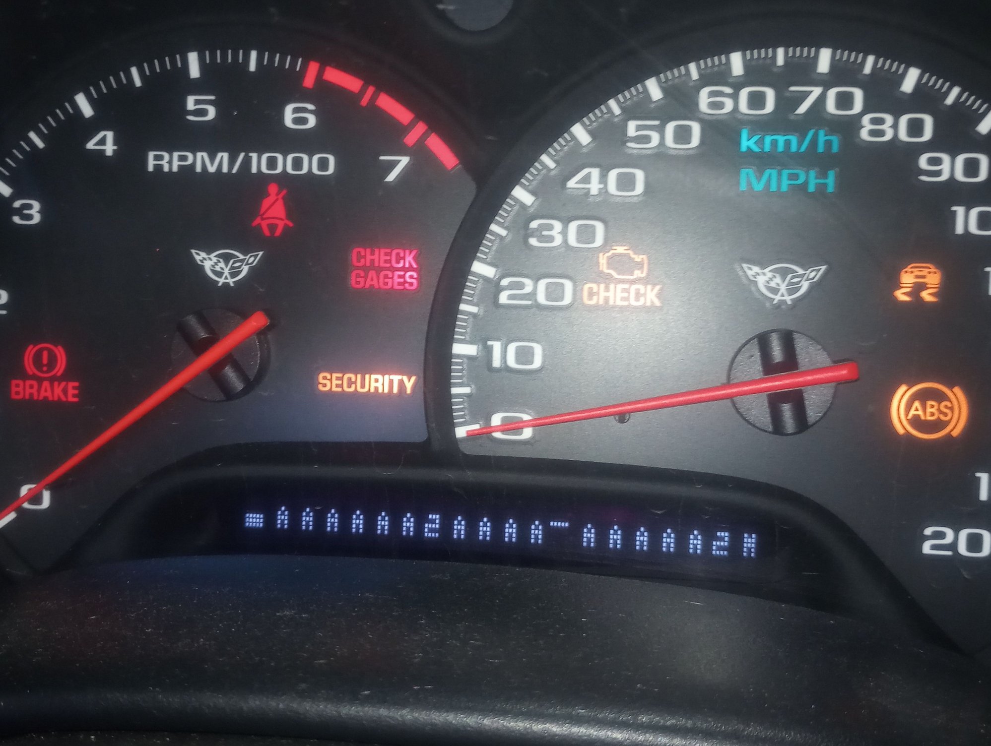

Attached is a picture of the cluster. There is no gauge sweep and the display seems to be nonsense. Also including the corrosion on the BCM that I cleaned with alcohol and soft plastic brush.
Another quirk, there's a irregular clunk in the rear. It sounds a bit like the trunk latch, but more muffled, from somewhere closer to the rear axle, 10 seconds, to 2 minutes apart. Gauges unresponsive, ABS and traction lights were a preexisting problem.
