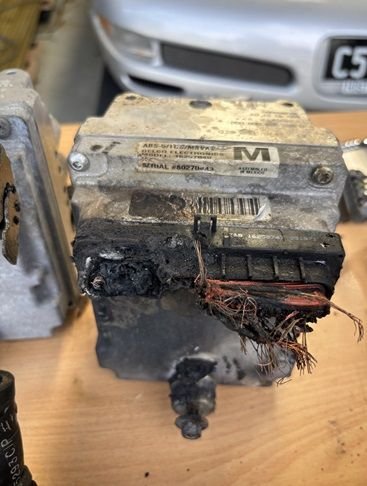

Has anyone got a Wiring Diagram for the ABS harness to suit a "M" Model ABS Unit located in the Front of my 1998 Base Corvette with no Active Handling
My Unit is Fried and Purchased another "M" Model Unit and Harness from USA

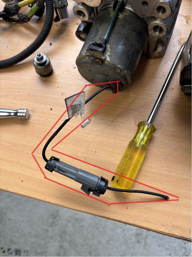

I have recently received a Unit and Harness but seem to missing the Wire that connects to the rear of the Module, my Harness had the below in it, but the Harness I received did not from the donor so just wanted to know if anyone can shed some light on where this gets connected to?

That is BPMV ground wire.

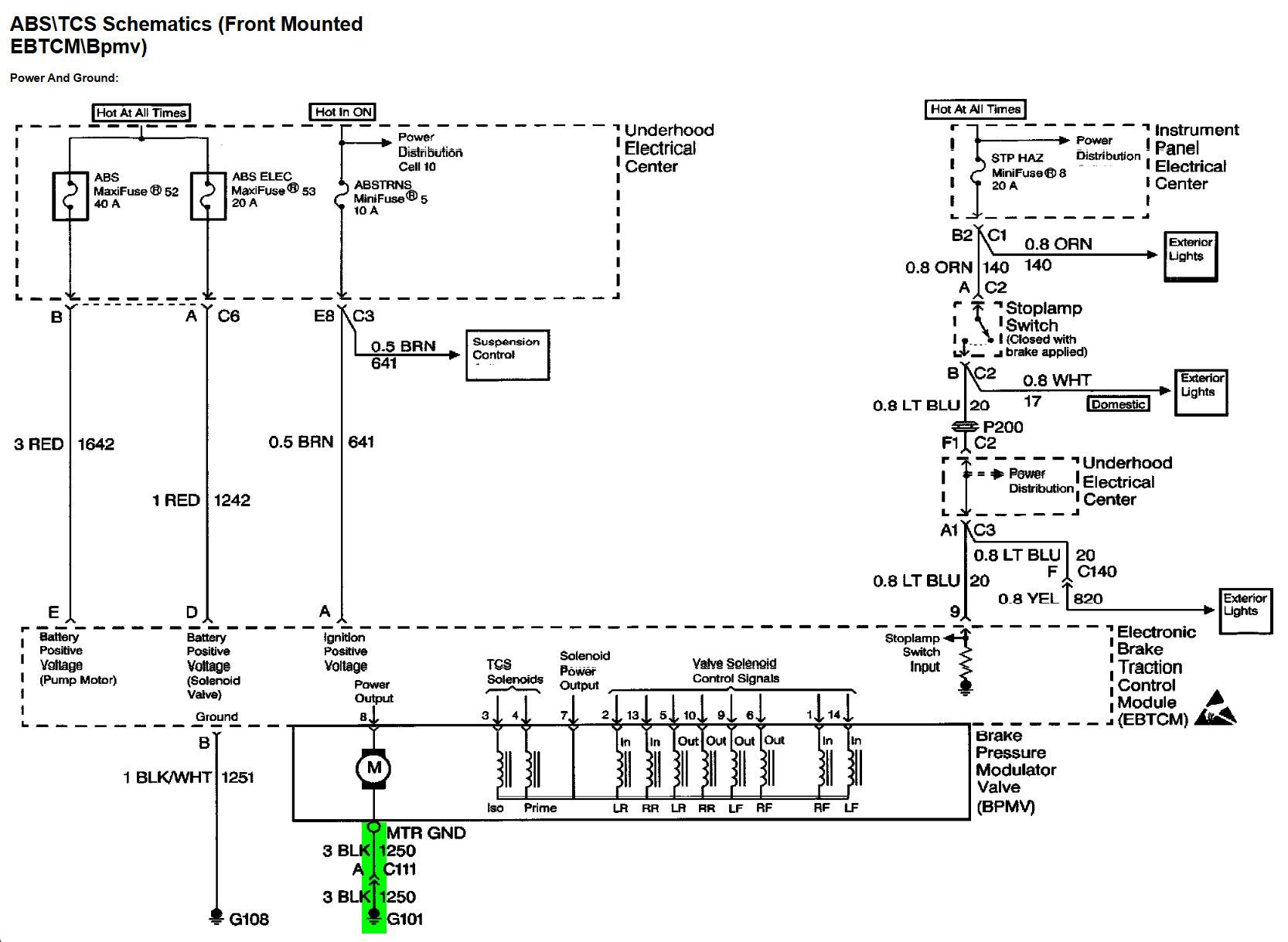

The wire w/ connector C111 below going to ground G101
