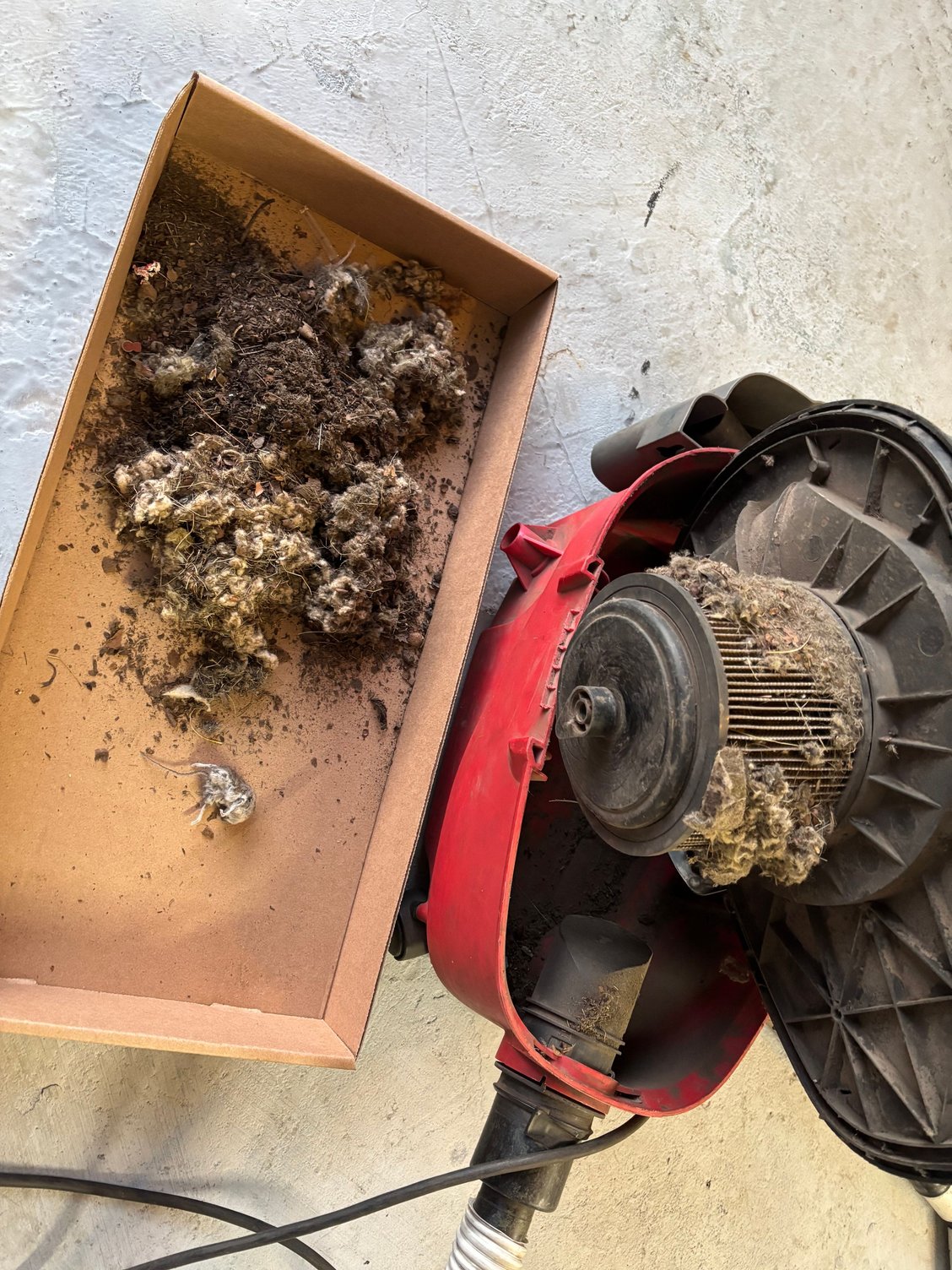

About ten years ago I found two mice in my blower motor that had been centrifuged to a 90 percent enrichment level! That area is so well insulated I never got the smell until I opened it up. I could here something clunking and thought it was a bad bearing.
It's not hard to get to the blower. Just takes a little courage to pry on the plastic parts.
I bet you have mice in the blower!!
