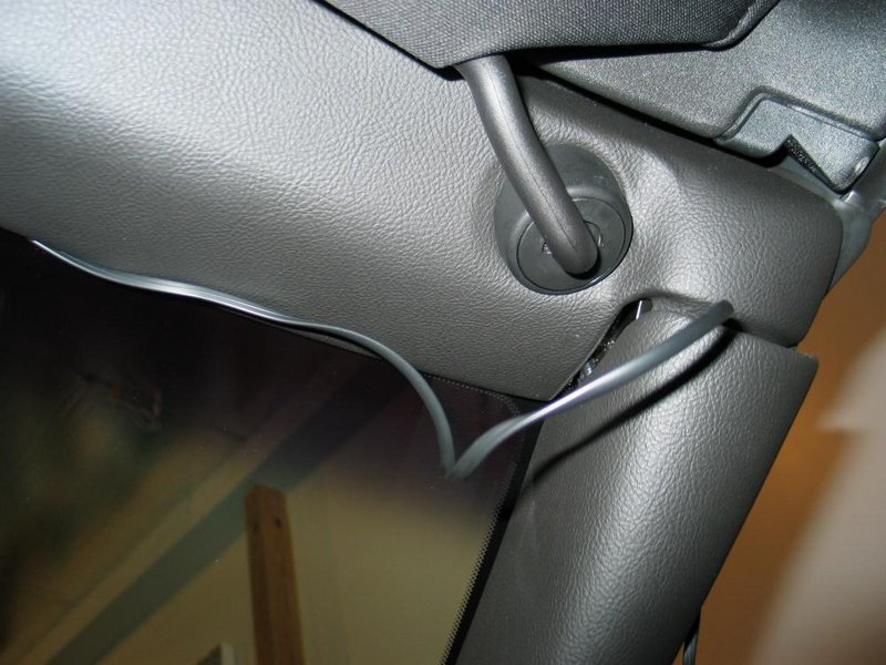

If you’re mounting it up high by the mirror, just pull the interior trim piece off the A-Pillar and fish the wire behind it.
Make sure the wire is clear of the fastener holes and then snap it back in place.
No tools required.
