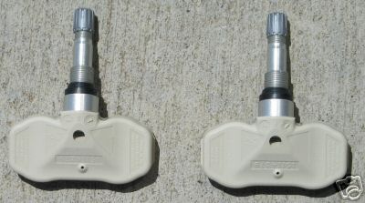

Might buy a set of 07 Escalade rims and tires for my 04 Avalanche. My Av doesn't use TPS's. Anyone know if the Escalade ones would work on a spare set of wheels for my 06 C6?

Don't think so!
Take a look at all the GM sensors below. GM uses sensors made by Schrader, and they all look exactly the same, except for color, and they all have different GM Part#'s. The difference is in something to do with how they communicate with the TPMS in the various cars. They also may require a different protocol to trigger them with a tire sensor reset tool. Our C6 sensors use the simplest transmission from the tool - a 5 to 7 second continuous wave transmission. Other sensors may require different pulsed or coded transmissions - some based on frequency pulses and some on amplitude pulses.
So......I don't think anything but the GM Part# 25758220 black sensor will work on the C6.
Bob
Here's the ones we need in all models of the C6 (unless it was made for overseas delivery):
Here are some for an '06 Suburban
Here are some the eBay seller says are for the '03 and '04 Escalade, Denali, Yukon
This one is reportedly for an '06 Cadillac
