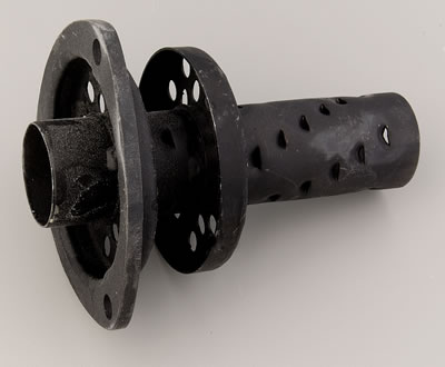

Car Chemistry exhaust inserts also have been reported to cure drone...
Those are a little pricey(sold as each vs set?) and so many sizes to choose from? Which one fits/ works with the Flowmasters?
