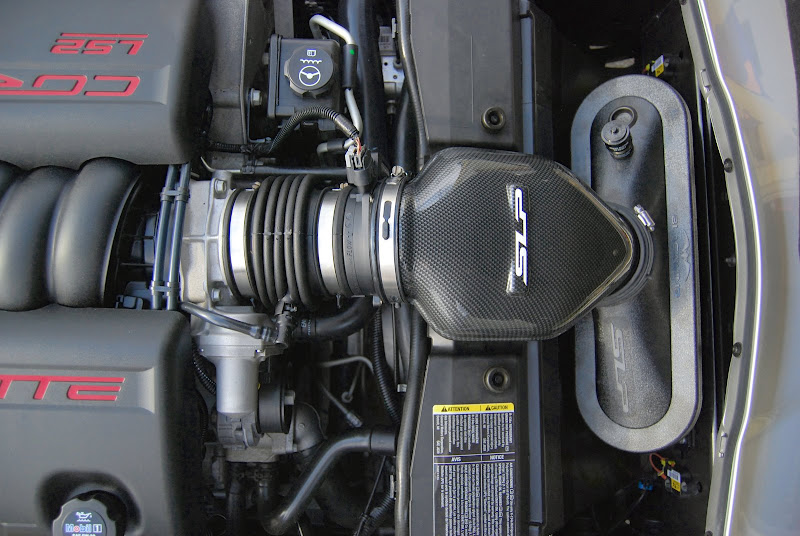

Ahhh, but here's the rub, I don't want to void my warrenty with a tune. I think I'm in that "happy place" right now with regards to the fact I know what's causing it and now have a simple tool to clear the fault when it happens - occasionally. If it were a persistently reoccurring fault I'd be tempted to return the CAI to OEM (I retained all the original parts).
I'd still like to know where to plug these "holes" that markr01000 is speaking of; again - pics anyone?

BTW here's a PIC of my CAI... I don't see no stinken holes.

I think whats drivin' me crazy is everybody sayin' that it is air swirling throwing the code but your problem only happens below 40 degrees! that leads me to say its the air temp not swirling.
