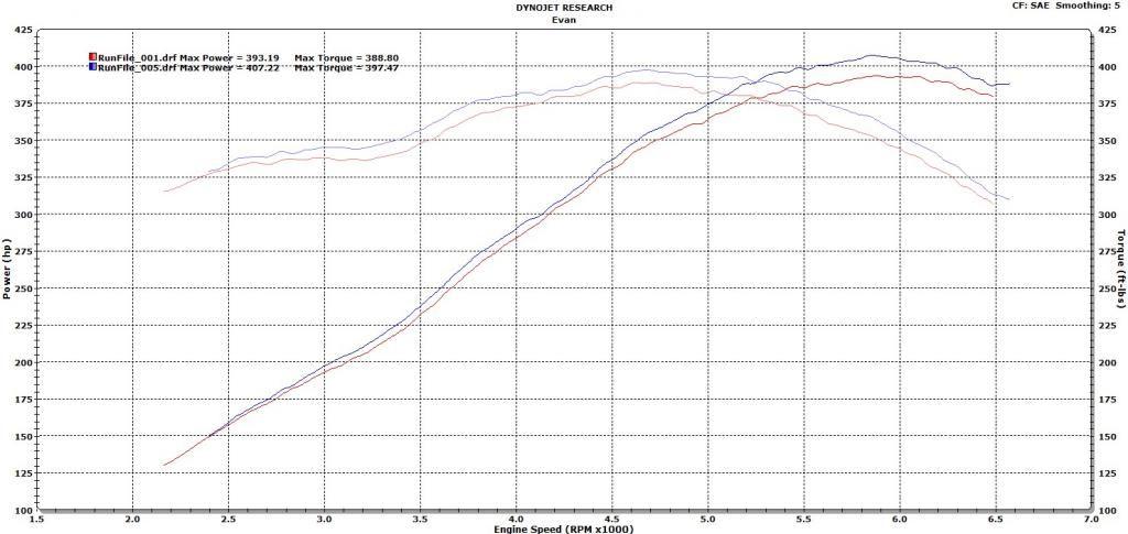

No, it should not. You can install them without retuning and pick up about 14-15RWHP. The issue that most modifications will run afoul of is the retuning of the ECM. GM will typically require verification of stock tune from the service department before signing off on major warranty work.

You DO NOT need a tune with LS7 manifolds. Did them on my 13 GS using LS7 manifolds, cat pipes and H-pipe with no tune and picked up 14RWHP. Personally I wouldn't see the point in doing them if you're going to do a tune unless you live in California. Otherwise if you're going to void the warranty, do headers and a tune, or go big like I did and do a blower.

I'm curious as well. Hey Evan, do you have the AF ratio part of that dyno chart? Thanks!

Sorry, no A/F on those runs, but I ran the car for a year in that configuration with no codes or issues.
