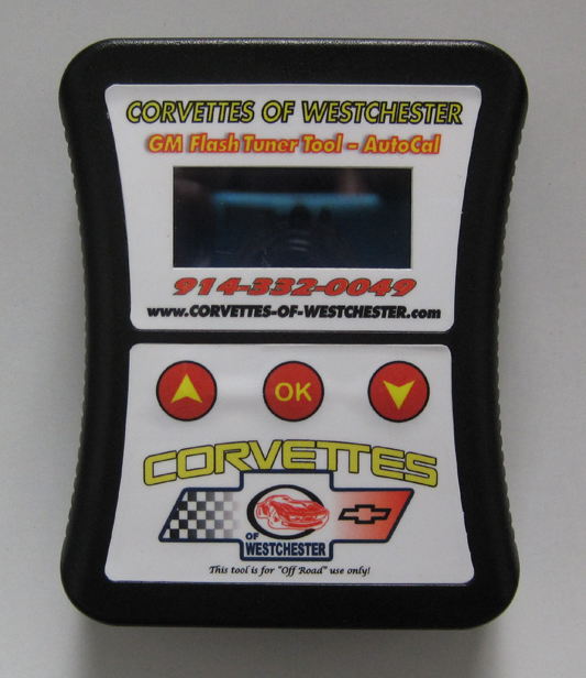

Nope.....The factory 02s will be fine, but you will need a tune.
Your absolute BEST option is the Chuck CoW AutoCal package....
You'll get a tune that's perfect for your car and with AutoCal we can DATALOG it to perfection!
CLICK HERE FOR AutoCal information!
