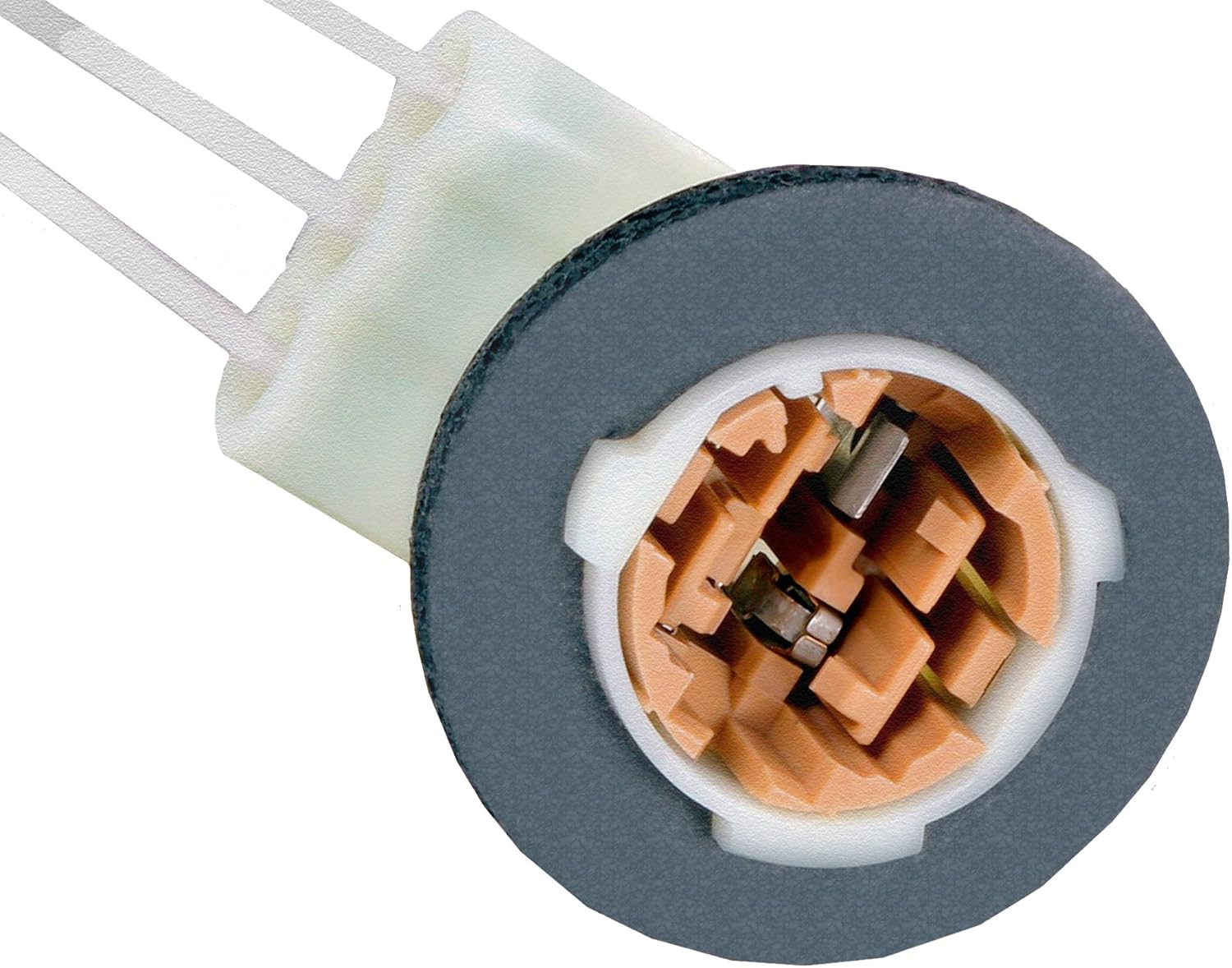

Problem is in the bulb sockets.
There is wide section one side, and a narrow section the other side. Its the narrow section that the prong will heat fold away from the center of the socket, and not make contact with the bulb tombstone wire.
So the fix is very easy,
Go in with a pick tool, get past the L top piece, and bend the inner small prong out more toward the center of the socket. Now hit the socket with some spray contact cleaner to clean up the prongs, then go on the heaver side with some dielectric (silicone) grease in the socket both sides before you reinstall the bulbs. The dielectric grease will help not only to keep the cleaned prongs from corroding again, but works as a heat transfer paste to help pull some of the heat away from the prong as well (so it does not bend back out again to loose contact with the bulb tombstone wires).
