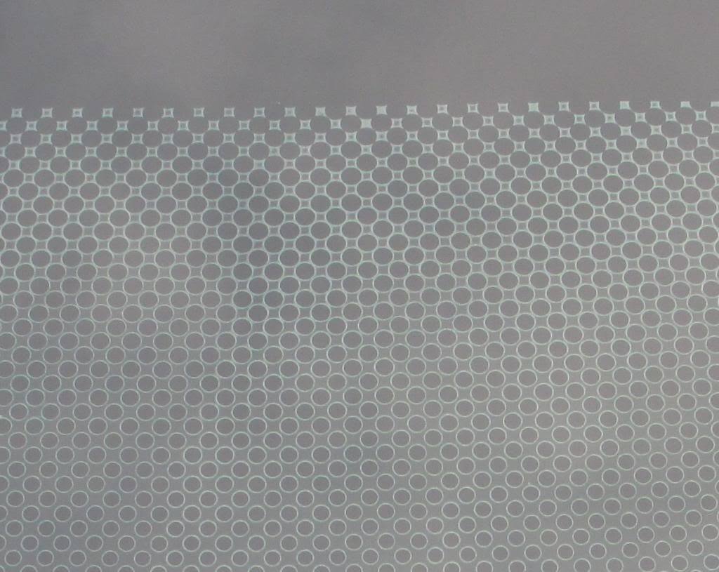

I'm a bit upset at myself for not thoroughly researching window tinting for vettes. I see that a discussion was held years ago, but didn't think to check the forum before getting it tinted.
Nevertheless, I took it to a shop, and the manager explains to me that tinting the rear window can be tricky due to the dot matrix, but rest assured that he can do it with no problem. After I took it home and washed it, I did not like what I saw. I took it back to the shop, and he tells me that he can clean it up and get the bubbles out using the heater. He did it, and it still did not fix the problem, so I have to go back for a third time.
The rear window looks tacky to me with the dot matrix being so clear and the rest tinted. I read the forum, and other posters recommended using vinyl?
I know a lot of you have tint on your vettes, so what do you recommend?

same thing happened to me. i told the window tinter that i didnt like how the top came out. he told me he would get back to me and then just never did. he never even charged me... but i was told that once the tint is applied it cant be removed without damaging the defogging element in the window...so its been this way for a few years now..

The dot matrix is difficult to cover. You can have them or someone else put a piece of vinyl over the dots and then re tint. I drove across town to a guy the specializes in Corvettes because of the rear window. It came out nice. Not perfect though. He doesn't use vinyl. He tinted the window, then lets it dry in the sun, then squeegees it back down. Something he came across on accident.

Another thing about a poor job on the back glass due to the dot matrix ... it distorts headlights at night to the point of possibly being dangerous. Mine was like that on the C5, but my C6 is not tinted.

I had mine done and the dots were covered with vinyl and the rest tinted. I'm very happy with the results.

I used a razor blade paint scraper to knock down the dots. Llumar 35%

The dot matrix is on a lot of other cars so if he did a bad job near the dot matrix area then its because he isn't good, and not because of the car.
I just had mine tinted and the dot matrix area is actually good, it seems the PITA part of our cars is the fact that the back window is so large and curved.

I was a Ziebart having Xpel installed yesterday. Thought while I'm here, lets tint the windows. They told me straight out, we do NOT do Corvette rear windows. It is to time consuming and labor intensive. So, I just had the side windows done.
Then I spoke to the installer, James, who said he has done them, they are difficult and time consuming. That he did do them on the side. We exchanged phone numbers and off I went.
Our plan is he will drive up (70 miles) come to my home and install the window tint, where time and labor costs are not a factor. Yes, there will be monitory rewards. I told him I'd barbeque, cold beer on tab and some cash.
I believe I too will attempt to remove/knock down the dot matrix before he arrives. I think I will go to the junk yard close by and practice a couple of techniques first. I will also have a piece of vinyl standing by.

I removed the rear window tint on mine (from previous owner) and the defroster works fine. The tint was too dark and made seeing out of it at night a real pain when backing up. I just peeled the tint off and used adhesive remover to remove the glue left behind.

Does anyone know what the Dot Matrix is for? I asked 2 guys at the corvette plant & they did not know,but they said DO NOT sand them off??...............

I think the guy lightly sanded the Matrix on mine. Not perfect but acceptable. He does them for the local chevy dealer is what lead me to him. Been over a year and no problems.

I don't know how much truth there is to this, but I recall it was to help transition from the black edging around the glass. So instead of a stark black edge on the perimeter, the dots serve as a transistion to make it more appealing to the eye.
