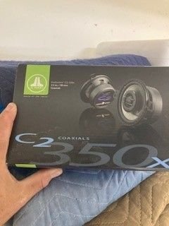

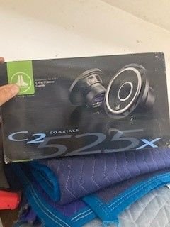

Here is what I have done to my 05 Bose System - the plan is to do a complete HU along with my BA components and RE Audio 10's with my Sundowner amps - just haven't decided to tackle it yet. But in the interim and without breaking the bank the changes mentioned below have made the Bose system a lot better and bearable to listen to. I did this a while back but you should still be able to find something comparable.
You can buy the GM speaker connections that leaves all the wiring OEM but I can't find where I ordered them from.
- Disconnected the Front Speaker on the dash (this made a noticeable difference)
Replaced the small door speakers with JL Audio - C2 350x Coaxial
Replaced the Rear Speakers with JL Audio - C2 525x Coaxial
