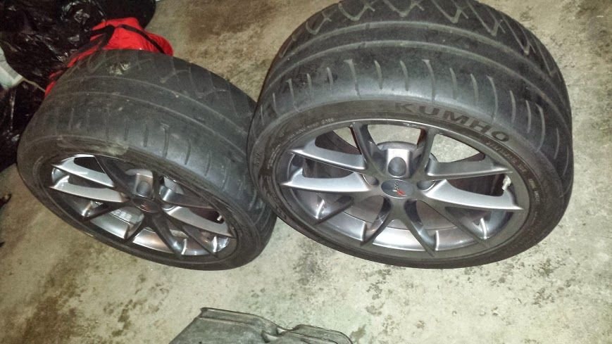

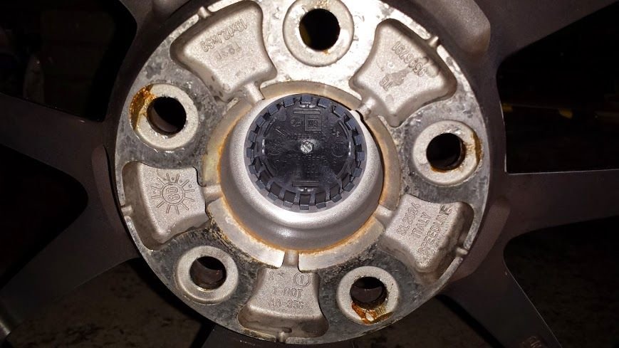

I have competition grey oem spider wheels available:
My spider wheels with kuhmo's:
