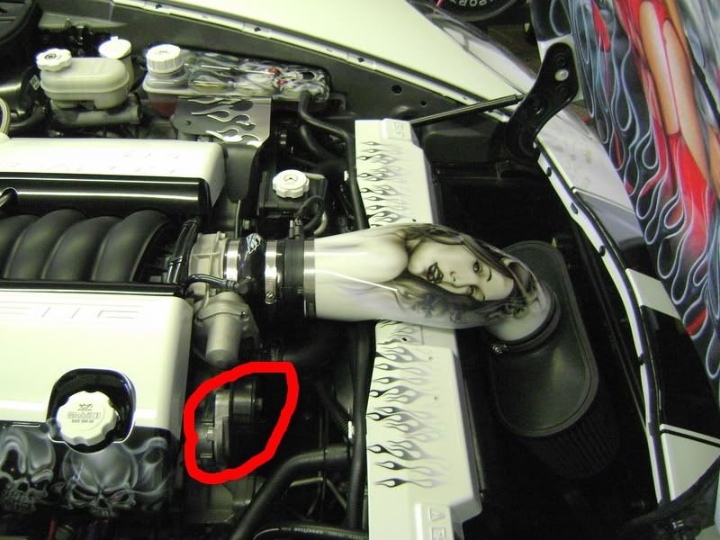

On passenger side top is a belt tensioner...just push it towards drivers side and slip belt off. Just took mine off yesterday. Also works on my C4.
This one
Now AC belt is easier due a long extension.
If you can push your tensioner over with your finger, it may be time for a new tensioner.
Takes quite a bit of pushing, but you may be right. I know I can do it on a new one on the C4.
Changed both belts at 100,000 miles and changed the Alt at 120,000 miles. Used a 1/2 breaker bar for the belt change and my hand the other two times.
