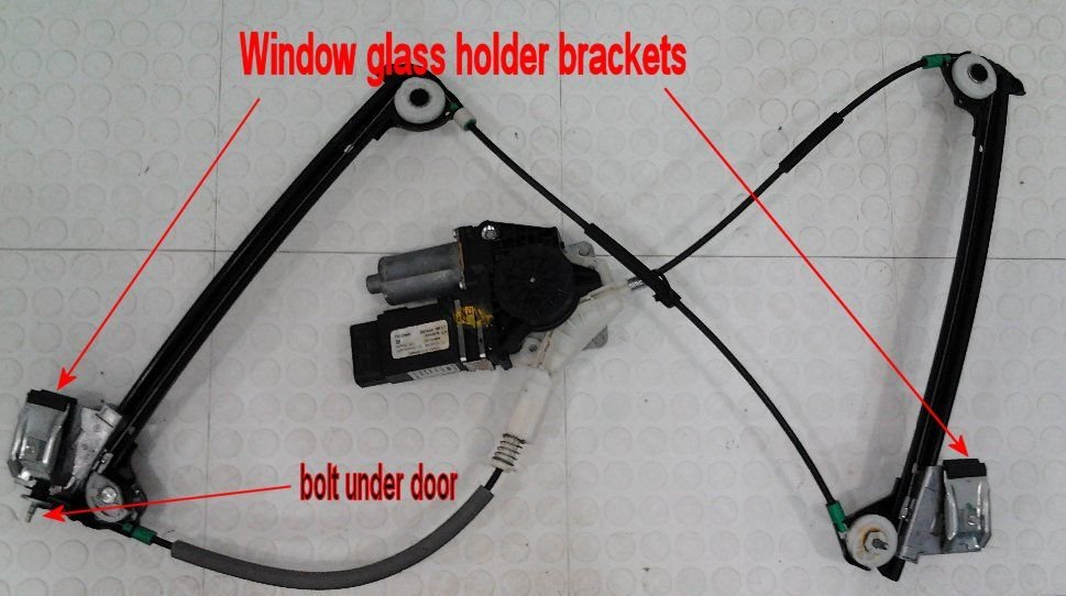

Your window regulator cable has rusted, a strand or two has become unravelled, and the cable is now stuck in the channel, and your window is now stuck open
You will have to take your door panel off, cut the cable, and raise the window, and use a piece of wood to keep it up until you get a new or used regulator.
I just went through the same scenario, exactly as you described.
The passenger door window will have no indexing, but you can still open it, but have to have someone outside to close the door by flexing the glass inward to clear the top rubber.
I also replaced the driver side with a new regulator because it gets used much more often, and it was starting to make some noise (squeal) I kept the old driver side regulator as an emergency spare.
This job is quite easy to do yourself.
Once you get the door panel off, remove the rubber membranes, mark the window where the regulator brackets attach, and loosen the window brackets (10 mm bolts) Once loosened, the window can be lifted off the regulator, and up through the window opening on top of the door.
Once the glass is removed, then the regulator bolts can be removed (6) at eye level, and one that is accessed from under the door (towards front of car) by removing the rubber plug.
Unplug the motor harness, then the regulator assembly can be removed through the door skin access holes, and the new one installed by reversing the procedure.
This is what the regulator looks like
Hope this helps.
