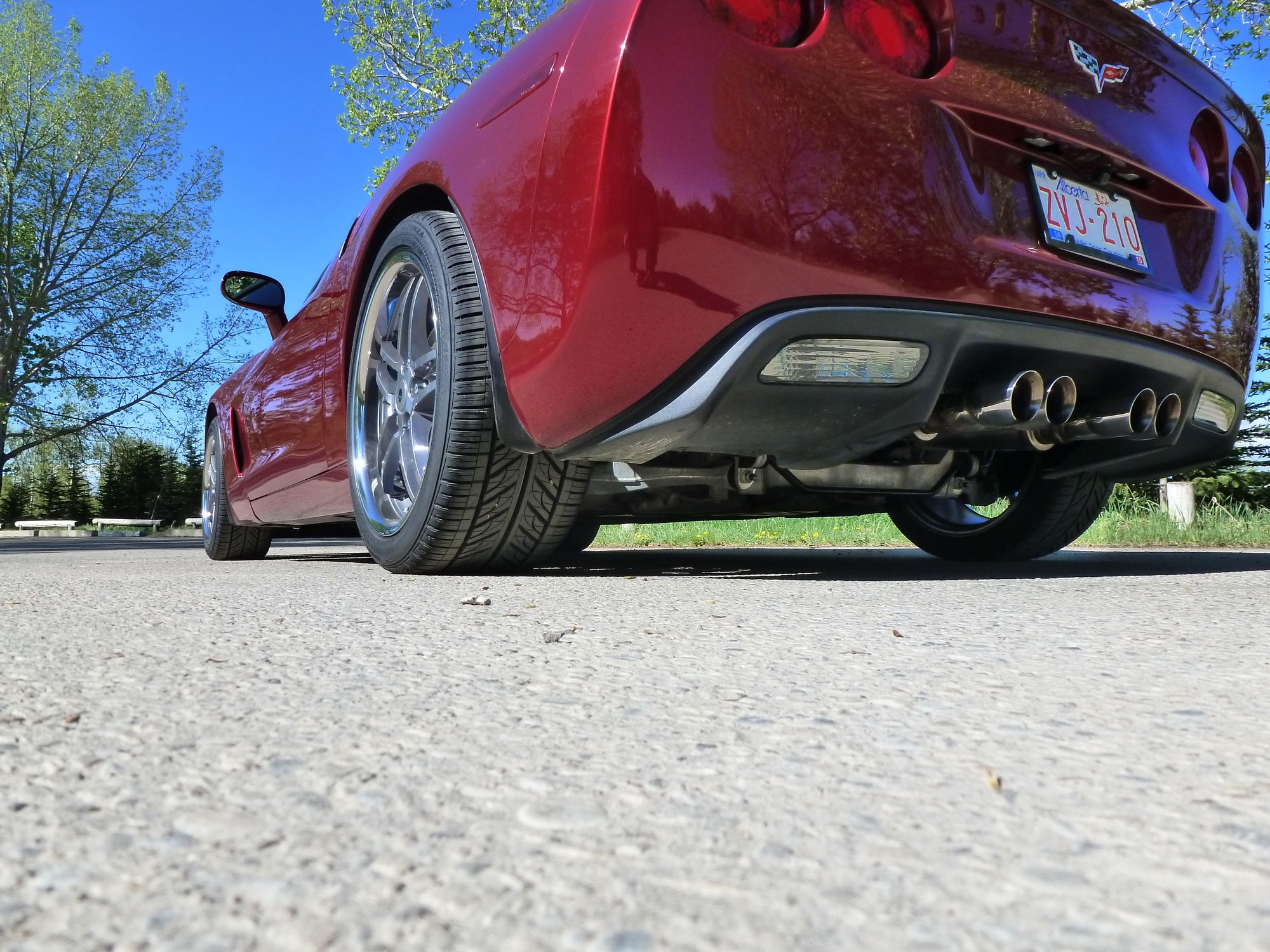

From: calgary alberta
This is a 10 inch wheel with stock size tire and 65mm offset. The wheel is pushed out flush with the fender. Be aware if your car is lowered the tire may rub.
