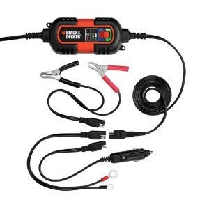

$20 at HD and Amz. Has all three attachment methods included.
The car even has a groove in the door sill to accommodate a tender cord in the "cig lighter".

Up the list, Black and Decker unit is not that bad, and can be had for around $20 at wall-mart or home depot.
Note, above two are for lead cell wet acid batteries, and not for AGM batteries.
