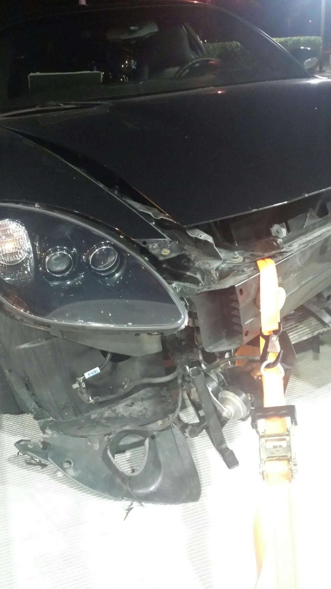

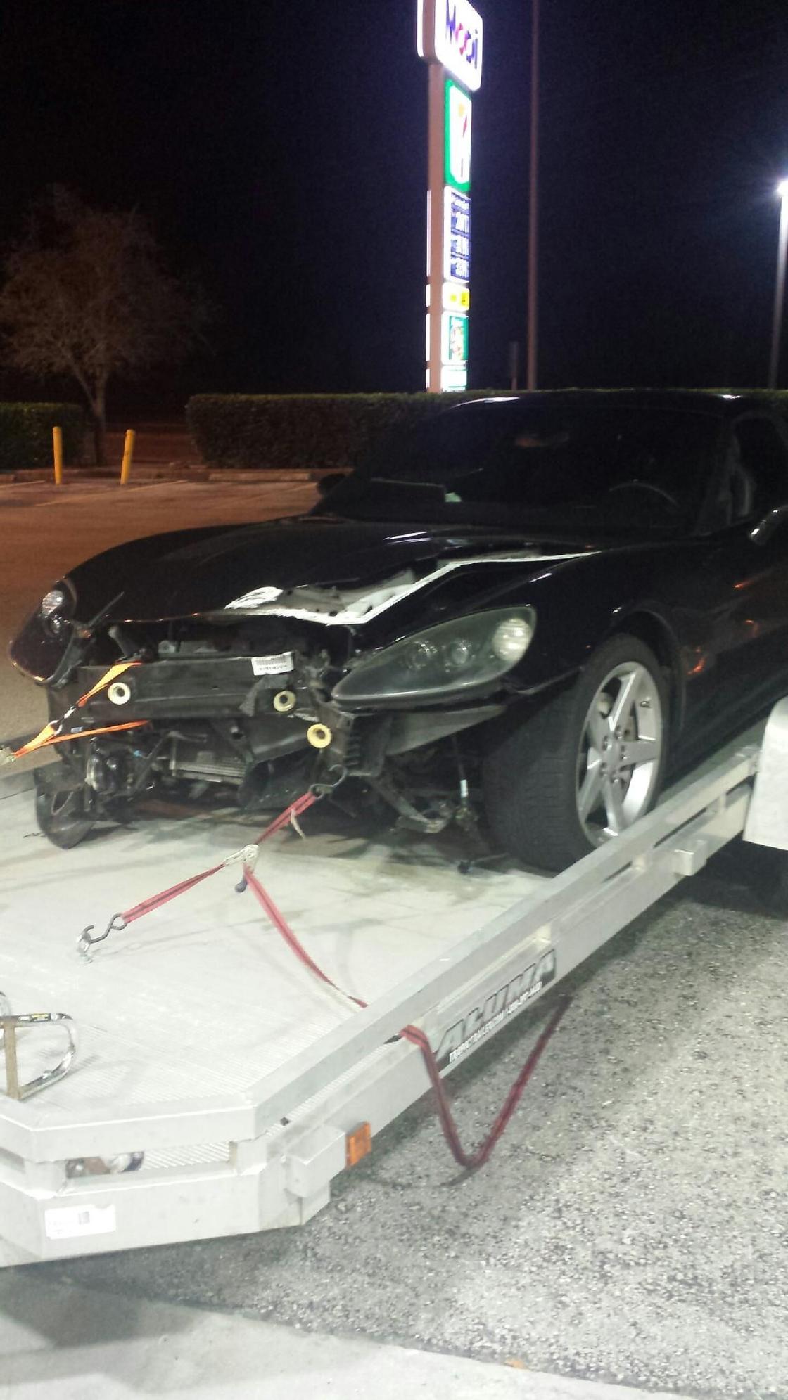

Hey guys, was in an accident and curious if you think this is even repairable. I know since there is frame damage most insurance companies will just total out my car, which i dont want to do. On the passenger side the side frame bent in a little bit but from what ive read can they cut it off and replace it? Also im located in SW Florida, Fort Myers where is the best shop to take my car around here, anyone have an idea of what this will cost to fix? Both airbags deployed as well. Bad situation all around. Thanks for any help.

First, insurance companies do not declare a car a total loss because there is frame damage.
State of the art laser frame machines today can easily correct a frame to within factory tolerances.
Second, any car is repairable vs. a total loss, but that relates directly to the value of the car. You don't mention the year, or value of your 'vette, so that's impossible to answer.
Last is the emotional aspect. When people tell you it will never be right again, yada, yada, they are not familiar with quality body work, performed in a modern well equipped shop.
With proper repair procedures and equipment, your 'vette can be returned to you looking better than before the accident.
The question is whether or not you'll be able to handle the rather long repair time, and all the emotional stress that goes with it.
If you feel you cannot handle it emotionally, then take the insurance settlement if it's repairable, and sell the salvage, and you'll make out ok.
Of course if the insurance company totals the car, then it's out of your hands.
What ever you do...good luck, and sorry about your troubles.

It's doubtful they'll want to repair an '07 with that much damage. But you never know how much damage really exists until a competent repair shop evaluates it.
If there are underlying reasons you prefer a repair, such as mods to unaffected parts, then work out arrangements to remove the mods prior to the ins co sending it off for salvage.

Our 2006 had similar damage after I T-boned a moron who pulled out in front of me.
IIRC, the cost to fix the car was about $18k and the value was probably high $20s at the time.
It took a couple of returns for adjustments, but in the end the car was in good shape.
But it was time consuming and stressful, so dumping it might be better if you have that option.

Make no mistake, your car is fixable, and will be fixed whether or not you choose to keep it or not. The damage isn't really that bad, and is concentrated to the front, so there's only one area to be worried about.
If you do get rid of it, Offleaseonly on the east coast of FL will likely buy it and sell it on their lot once it's fixed as having had a "minor front collision".
As far as if you should keep it or not, that's a decision only you can make. Diminished value will be a factor if you keep it, so make sure you go for that as your now wrecked Corvette is worth less than a non-wrecked one.
The real question is, do you feel safe in the car if it gets repaired. Good shops can fix it to better than when it came off the factory line. The question is if you will trust them and the car.

originally he stated he didnt want to total the car, which probably means he wants to repair it.
he also didnt ask if he should or shouldnt repair, he asked if we thought it was repairable.
imho once u get the frame straight u just need to replace the busted parts an it doesnt look all that bad so i say yes it definitly looks repairable good luck whatever u decide.
