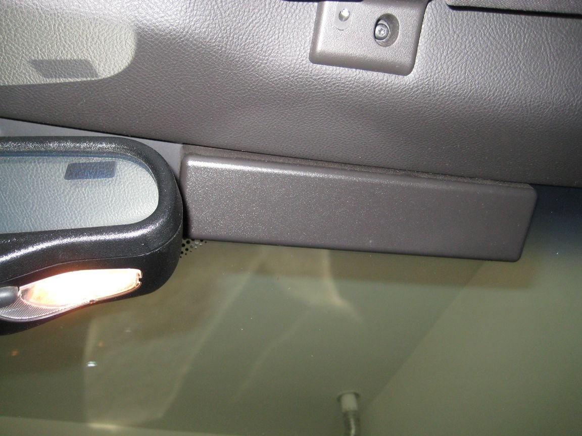

Here is a pic of the mount to the windshield....

If you sit in the passenger seat, you should be able to see it. It's tucked up to the right of the RV mirror.

This is the OnStar antenna. If you don't have this on your windshield the previous owner may have removed it.

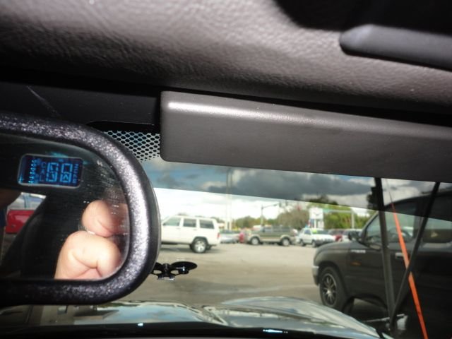

Another view of the antenna to the right of the inside rerview mirror and top of the windshield. The one with the white is from below.
