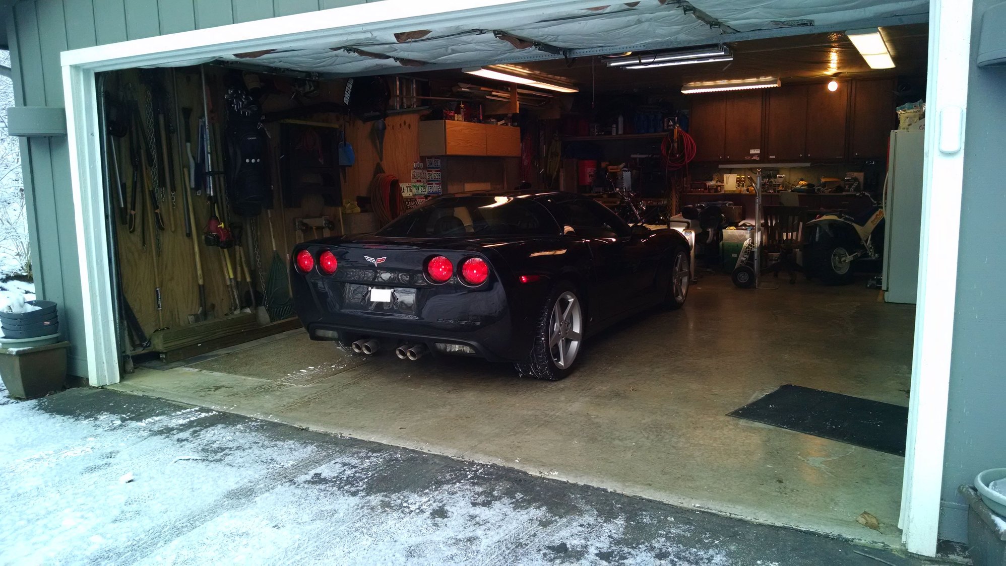

I just got my new to me 07 C6 Z51 w/ 15k on the odo. She's a cream puff. Going through the car like we all do when we first get it (and it snowed here the night before so I can't drive it) I found the clutch reservoir empty. The short drive from unloading off the truck to the garage the clutch felt funny but thought it was a learning curve. I plan to clean out the debris in the bottom and do the ranger method to top up with Dot 4 Syn. I do not see any dripping on the floor, but like stated it wasn't driven far nor was there enough left to leave a puddle.
Has anyone had this happen and found that after topping it up all was good?
