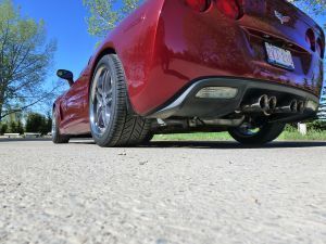

I have these wheels from O.E. Same size and offsets. The rears stick out MORE then stock, not less. If your car is lowered, you may have issues.

Will you post a few other pictures of the wheels?

s1001.photobucket.com/user/montereyredvette/media/newwheels008_zps2d2dc521.jpg.html][/URL]

That's what I'm talking about! NICE!
