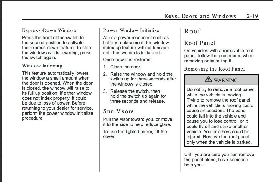

Question? My battery was disconnected on my 2012 c6 . As far as indexing the windows so when i close the doors the glass will close . How do i program this. Thank you.

Window Indexing
This feature automatically lowers the window a small
amount when the door is opened. When the door
is closed, the window will raise to its full up position. If
either window does not index properly, it could be due to
loss of power. Before returning to your dealer/retailer
for service, perform the power window initialize
procedure.
Power Window Initialize
After a power reconnect such as battery replacement,
the window index-up feature will not function until
the system is initialized.
Once power is restored:
1. Close the car door.
2. Raise the window and hold the switch up for three
seconds after the window is closed.
3. Release the switch, then hold the switch up again
for three seconds and release.
This info is found in the owners manual. If you don't have one, then here is a PDF of a 2008, but they are mostly all the same.
