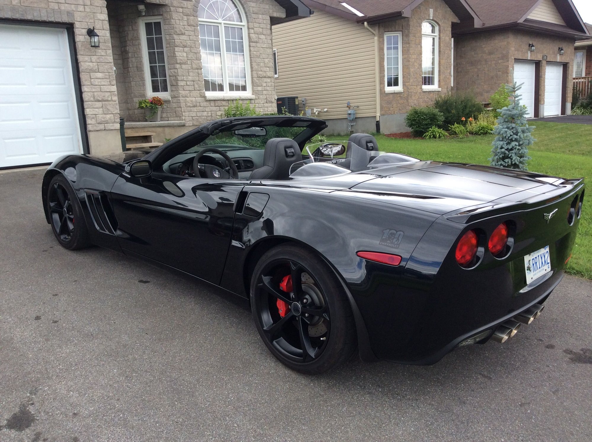

OK, make me an offer. It's a 2012 GS, 12,000 miles, all black, 4LT, manual transmission, mild to wild exhaust, convertible with Wind Restrictor, Chevrolet 100th anniversary edition. Make it quick, the Prius I want won't be there forever. The local Chev dealer also has a Spark in a pretty colour that I'm interested in.

WOW..... id be more worried about ruining the front of that beauty with that license plate, then the tire chatter in the front....
Really? My front license plate? In the Province of Ontario we are required to have a front plate, what would you suggest I do with it?
Yeah here in the great state of California as in many other states we are required to have them as well.....But most don't run them and ruin the front bumper.....there are other ways to attach the front plate with out having to ruin the front bumper....
