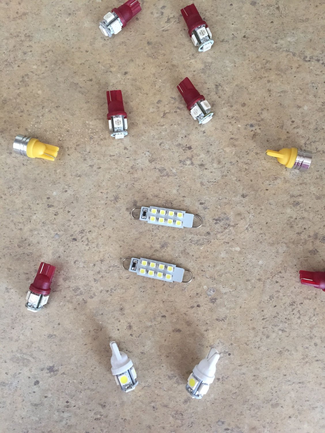

Hey guys,
Just received my complete LED kit from JWmotoring. the LEDs all look like what I was expecting but there are 2 rectangular ones that I have no idea what to do with. Anyone with experience on this have an answer?
Old May 6, 2015 | 03:17 PM
wayback's Avatar
wayback
Joined: Aug 2006
Posts: 25,105
Likes: 3,156
They go in the hatch, in the corners. Easiest to replace. Mirror are the hardest. I used a small pair of channel locks.

Okay i'll take a look. Was just off-put by their appearance, thought i'd have to do some complicated electrician stuff. But i'll take a look in the hatch and will probably better understand..

The kit i ordered was just a sack full of the red ones.. im obviously missing those yellow ones and the rectangles for the hatch... albeit I did get mine from ebay... lame.
where do those yellow ones fit?

I bet the yellow ones are for the mirror. Just need light directed down.

Yeah those just loop around the contacts for the trunk lights. The lights in the mirror are a pain. Make sure you get the lights to turn off before removing otherwise you are pulling the lights off while they are lit, and they get hot. For me I wrapped a little piece of masking tape around the bulbs to get a better grip on them and was able to get a pair of needle nose pliers in there enough to wiggle them back and forth. Some use dental floss and loop it around the lights (didn't work for me). wiggling them got them out easier.

The smaller yellow ones are for the front side markers, they are smaller due to less room under the plastic of the marker. And I got my latch ones on, did burn myself a bit, didn't think they would get that hot that quickly! Lesson learned.

So the red ones...will work for all the interior even the map lights? just will need to get those others for the rear hatch?

Exactly. The hatch is the only one that requires the rectangular looking ones.

Yes. My kit only had two types. Interior and side markers were the same, hatch different.
