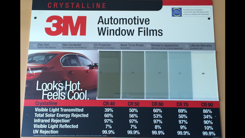

I always seem to be driving into the sun, and in the summer heat my hand on the steering wheel starts burning up. I got 3M crystalline tint on the windshield. I went with the "CR70" and sometimes I wish I went a little darker. Honestly, it's completely unnoticeable, even at night. However it works as advertised and keeps my hand completely cool when driving into the blazing summer sunshine. I'm very pleased with it.
P.S.- it doesn't cause any interference with the GPS or cell reception.

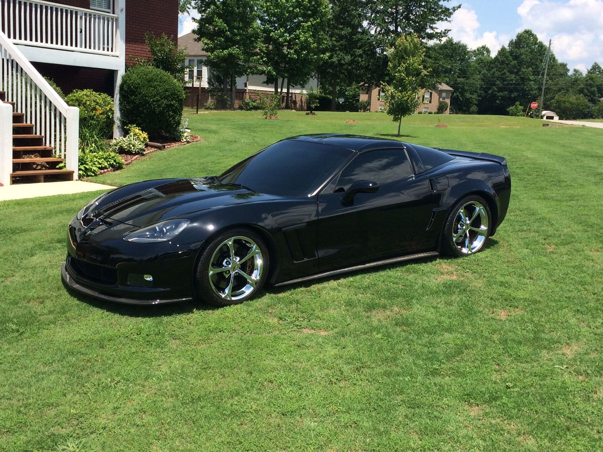

I have 20% Ceramic on all windows of vette and my truck. Truck has been that way since I bought it in 07. Never had a ticket or been pulled over for it. I also put hid in fog lights on both my truck and car and feel that my vision is not much different with the added light output.
Picture of my truck behind a vette I polished last weekend.

It refers to the amount of visible light transmitted through the tint. It's a little misleading if you don't have experience looking through different tints, because 35% is still fairly easy to see through. Just as the 86% on mine is almost impossible to notice. 20% on side windows is not enough to keep you from seeing what you need to see. 5% (aka limo tint) is too dark for anything but the rear if you don't want to roll down your windows to see to the side of you at night.
