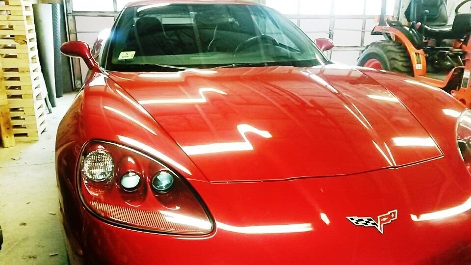

The wood wheel cribs work great. In the picture below the cribs are stored to the left of the car. I've never used them on my C6 but my C3 spent most of last winter on them. I made mine from 2X4X12" and 2X4X16" pieces. I went with 4 courses lengthwise and 5 crosswise which gives me 16" lift from the bottom of the tire. Total cost was $40 in materials and a few hours to build them.
