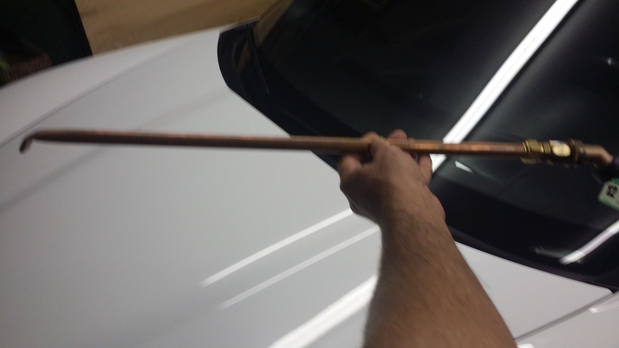

Yes.
I made a wand to flush the radiator and condenser.
