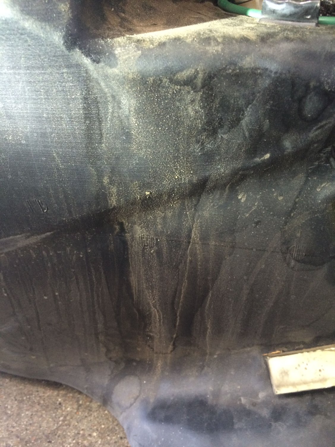

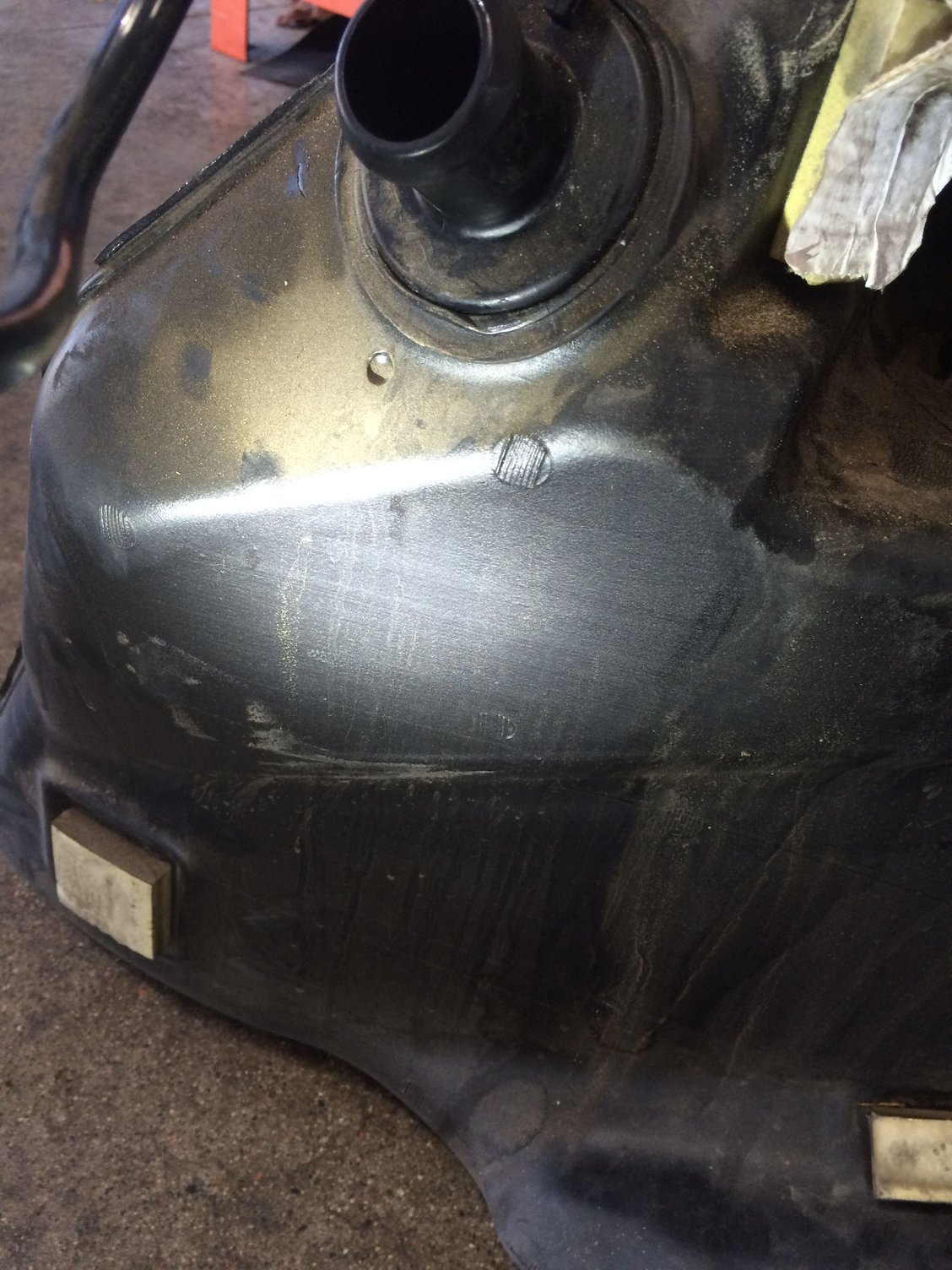

The mechanic showed me stains on the tank and said that it was leaking

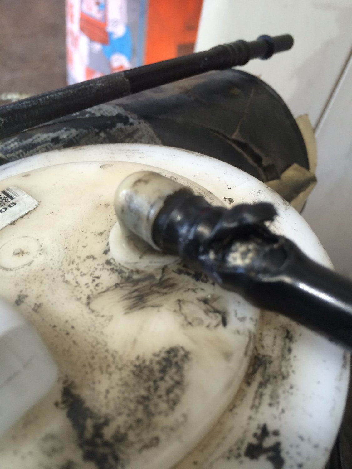

The fuel pump obviously was a problem

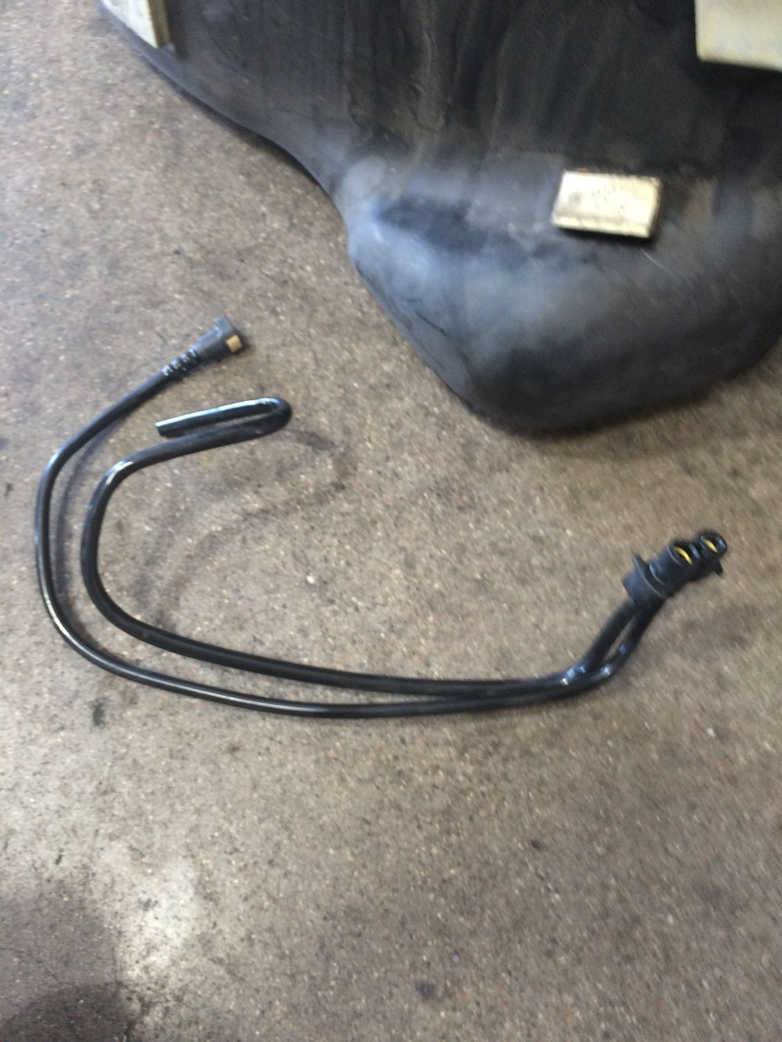

These parts were also replaced
I don't know what you guys think, but I fail to see a problem with the gas tank. It has stains on it but then it should if the pump was leaking. The list price for just the tank was $995. A lot of money for a piece of plastic

The tank looks like just some dried gas overflow from a fill up. If there was a crack it would have been dripping on your driveway. Hmmm....

I would think if they put a pressure test on the tank it would show if it was leaking. A little late now. If you made them pressurize the tank while you watched, would they refund the cost of the tank? I doubt it! They basically replaced everything.

So I have a 2008 corvette and it seems to be leaking from the neck of the tank as well I checked the fuel pump and it's fine, so did the dealership fix the neck or replaced the whole tank because it looks like it has a rubber seal and the neck screws in the tank 🤔

The fuel pump & the associated hoses are a known leak problem, but it is unusual for the actual tank to leak
