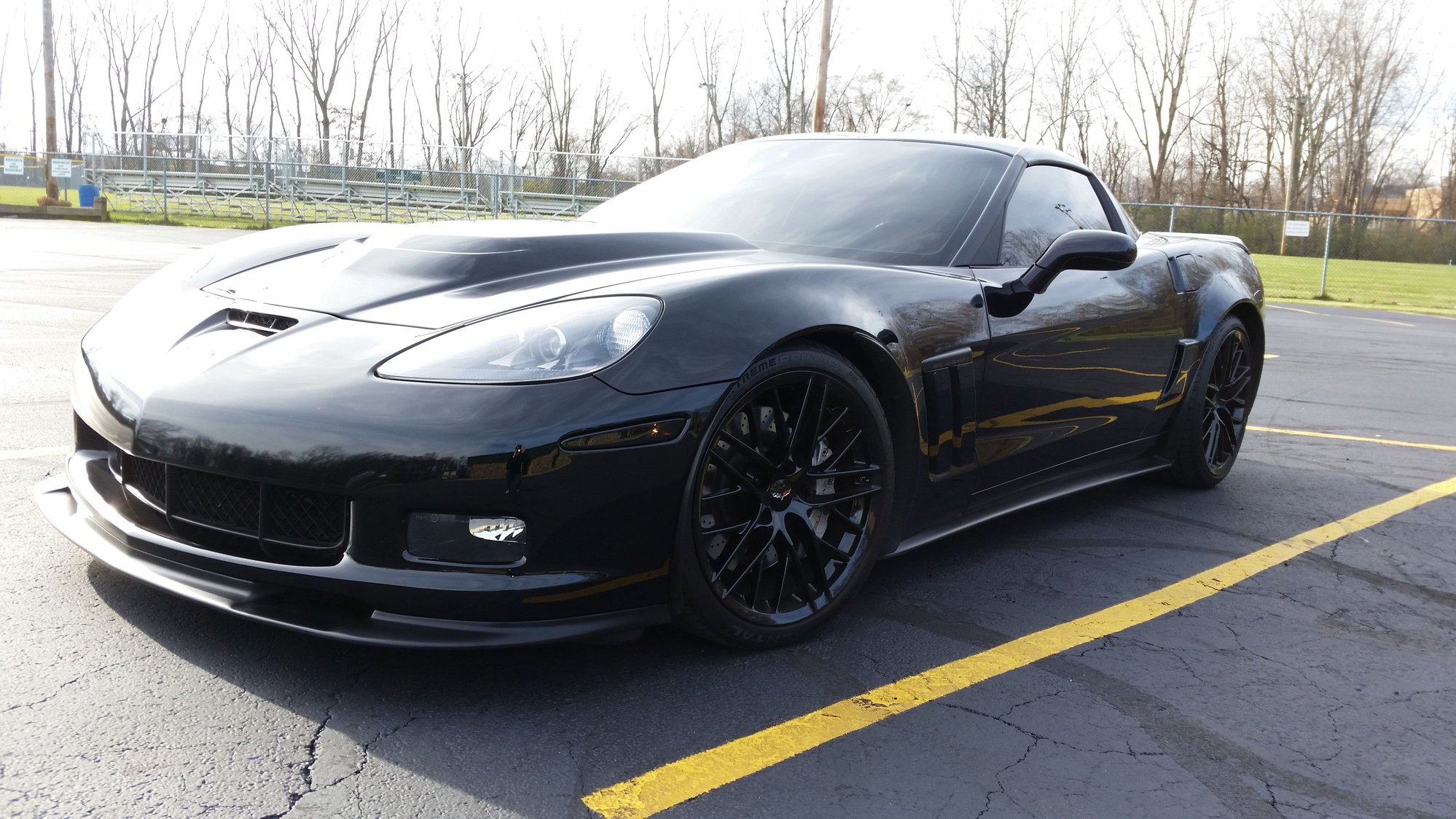

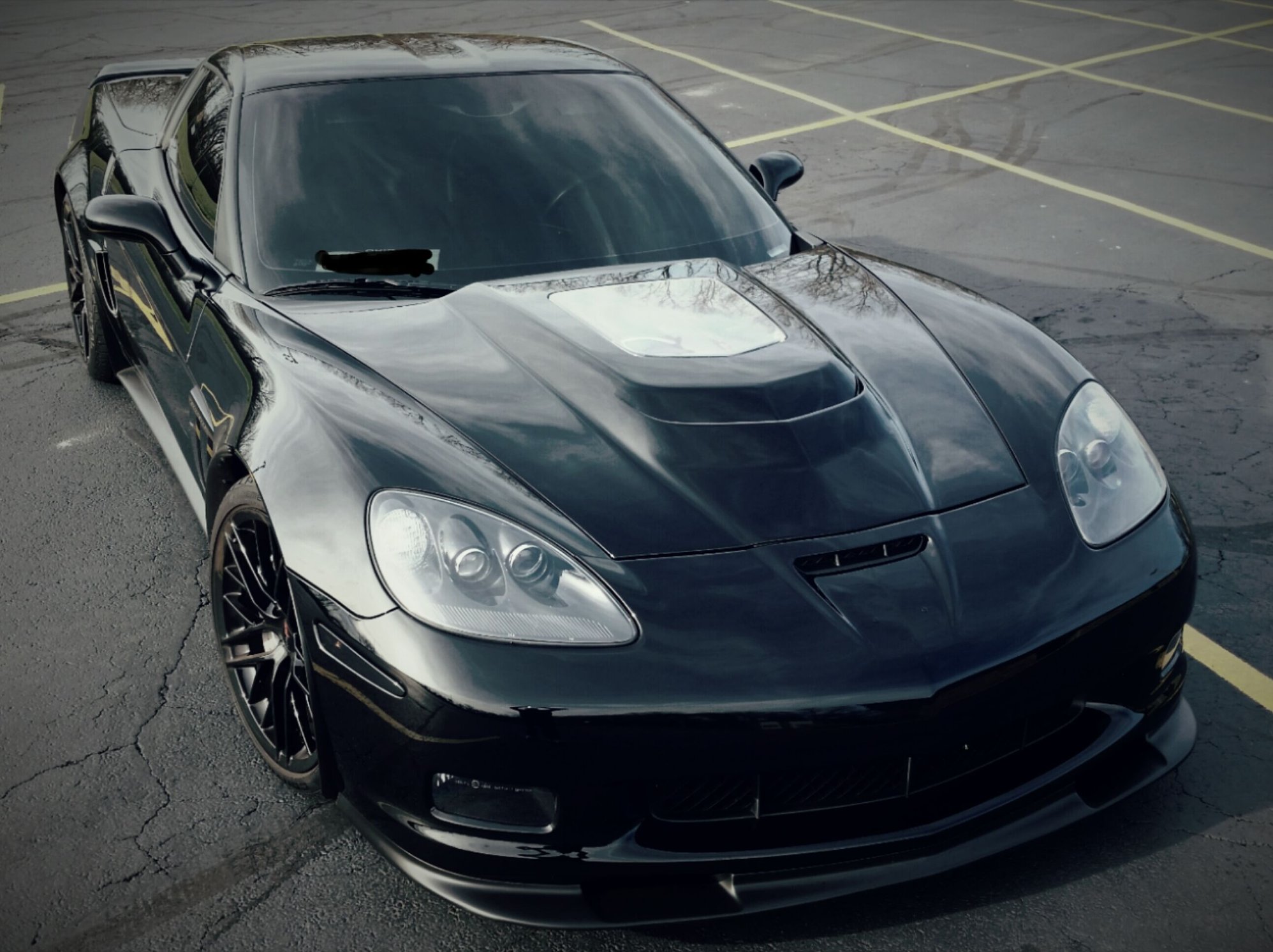

I already had the hood done for the intent of a top mount. I just need some other opinions on all of it.

Whoa.. that hood is pretty cool.

Nice ride Ron...

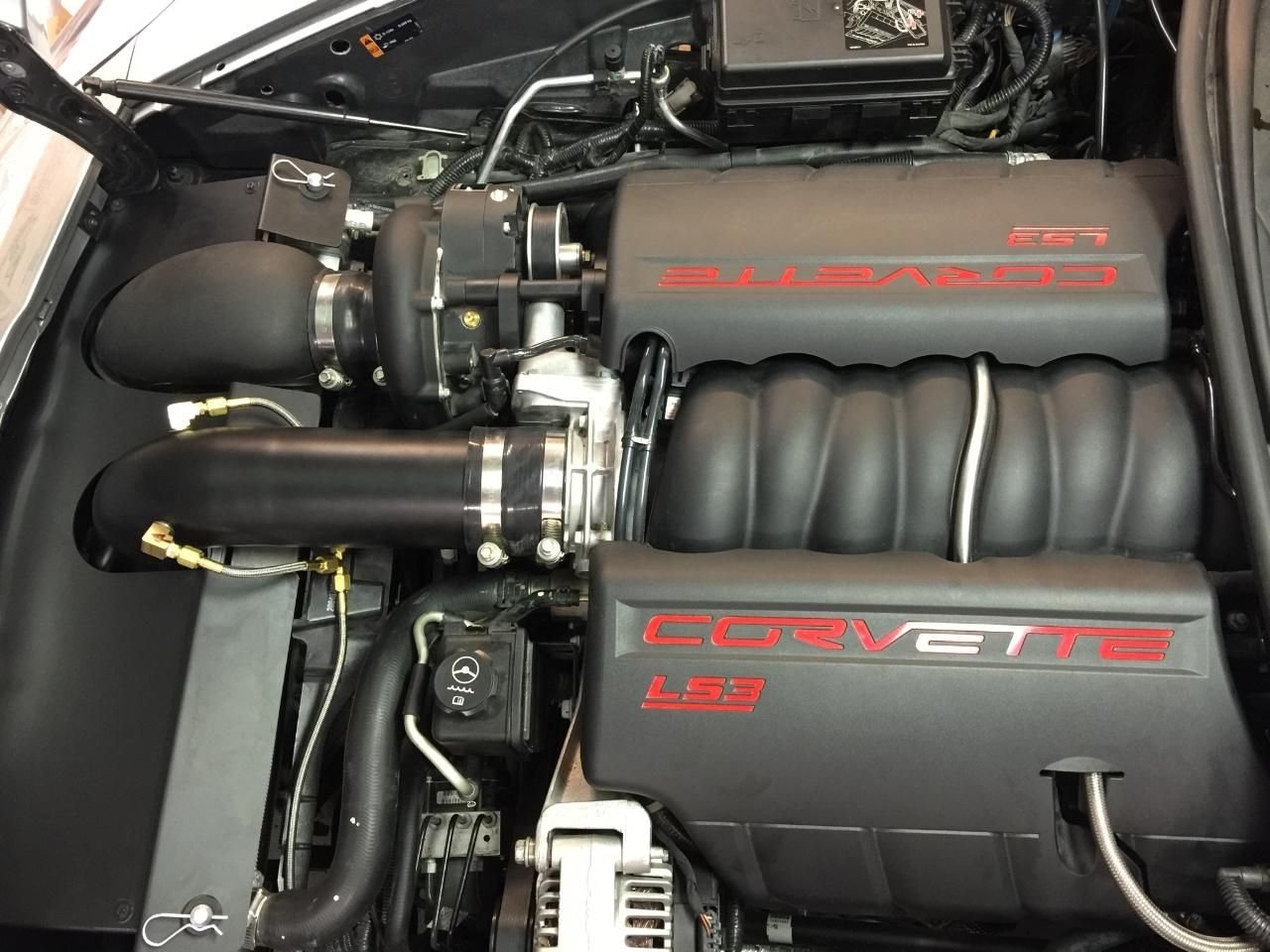

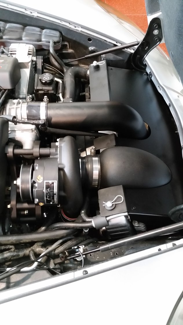

Do it, you won't regret it no matter which blower you pick. Personally, I prefer the centri (A&A or ECS) because it's less noticeable under the hood (although that's not as true now that I have dual nozzle meth), has more HP potential, and doesn't add a bunch of low end torque. Our cars really don't need any more torque, even stock they can roast the tires, and there's a reason GM put PTM on the ZR1s.
For anyone concerned with heat, do the Dewitts radiator (comes with the A&A kit for GS/Z06 and can be added to the base A&A kit or ECS kit). Also, you might as well do meth from the start as you'll be adding it eventually (especially if you don't have 93 octane available).
FYI, the car made 407RWHP with just Z06 exhaust manifolds before the blower, and 600RWHP after the blower. Then 672RWHP with 3.6 pulley (11psi) and meth.
Obligatory blower pics:
Just A&A kit:
Dual nozzle meth added:

Looks nice..Satin black is the way I would go too.
