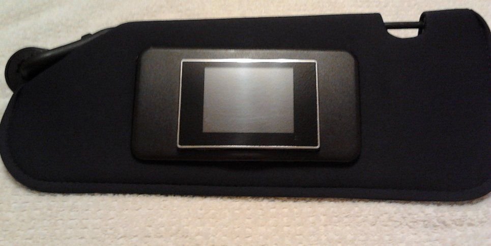

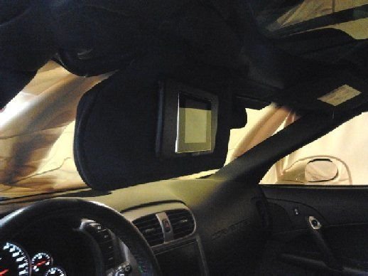

I was in the same predictament some time ago. I have the OEM Nav, and didn't want to change it out with an after market unit, just to get a Back up screen.
Since one of the hinges was broken on my driver vanity mirror, I bought a 4.3" monitor and used the vanity cover to make a template for the monitor to fit into it. What I like about, it's a stealth monitor, not seen unless one flips down the sunvisor.
Here is how it turned out.
installed in car

Al,
The Nav Tool was not available 3 or 4 years ago when I did this. The Nav Tool is $400.00 as well, so at that price, I may of opted with an aftermarket stereo/Nav unit for a few extra $$.
I'm happy with my monitor location. I actually have my camera mounted in the front,on top of the center air dam deflector and use it as a front parking camera, not as a back up camera.
I seldom use the camera/monitor to park anymore, because over time, I have learned how far I can go before hitting a curb. Having the camera, and lot's of practice, I have finally figured out how far I can go.
I think that over the hibernation period, I may just swap the camera to a rear back up camera, and use the same monitor.
There was a little thinking out of the box when I decided to mount the monitor in the sunvisor. I took my time and made a PDF of it with pictures.
If you ever want to attempt it, I can certainly forward you the PDF file.
