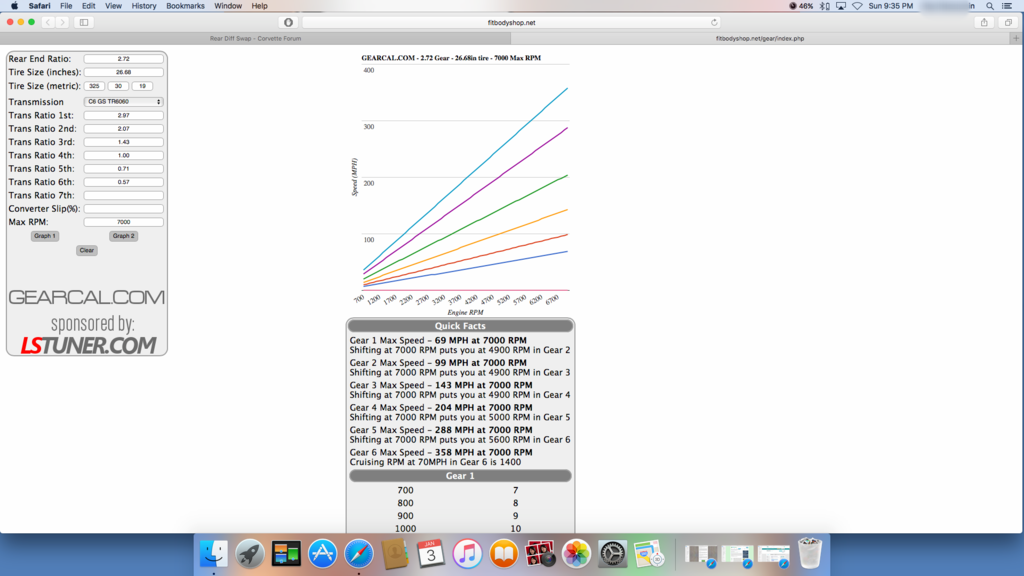

Originally Posted by switchblade six
I seem to be doing something wrong. Tells me that I will be doing 358 MPH in 6th gear @ 7000 RPM I give up. I will call a gear shop in morning. Thank you for help.
It is mathematically correct
Theoretically your car would need probably ten times the power to pull to 7000 rpm in sixth
The short answer is it will wake your car up in the lower gears first to fourth

ignore the overall speeds just look at the speed difference in the two gear examples
remember 4rth gear is one to one ratio 5 and 6 are overdrive

I calculate 2000@70mph with 3.42 gears and 1700@70 with stock 2.73 gears. On your chart you chose the wrong trans if it is an A6.it is a 6l80e.

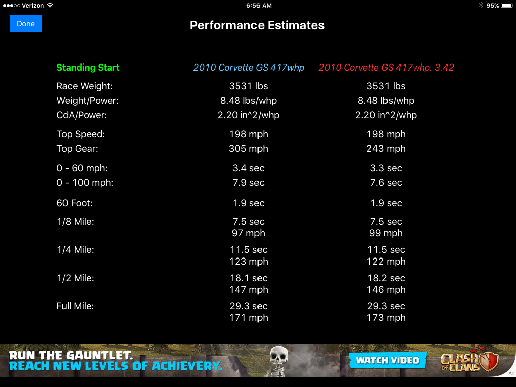

2.73's Cruising RPM at 70MPH in Gear 6 is 1500
3.42's Cruising RPM at 70MPH in Gear 6 is 1900
Also to give bench racing math, on the 3.42 gears... .1 sec faster to 60 , .3 faster to 100, same 60 foot, same 1/8 mile, same 1/4 mile, slower 1/2 mile by .1, and same 1 mile.
Steve, Thanks. By looking at that info. it makes me think of forgetting gears. The only big difference that I see is .3 tenths quicker to 100 mph. I would of thought a half second for sure. We have to take into account that this was done on a track. Same driver? Same conditions? Love the side by side comparison. Side note I thought the GS weighed in at 3250 lbs.
His image was a simulation. You would notice the gears on your butt dyno when doing city driving more than anything.
And if that simulation is for a standard Vette then the 1/4 mile times are way off as no standard is gonna run mid 11's in the 1/4......not even the glorious GS....LOL.
Yep, not standard. Was based on 417whp, and a A6, This is very subjective of course which is why its call bench racing. so yeah lol
When I first saw your chart I was like something aint right with it. But a nice conversation piece.
weight + driver and some fuel (aka race weight)
That chart still doesn't seem right.
Our 2009 with the performance axle (2.73?) diff upshifts at redline 4th to 5th at about 165 mph.

That chart is for a 2.73 gear with a 6 speed stick with 325/30/19 tires. An A6 near 6500 rpm Will shift 4th to 5th near 165 mph.
